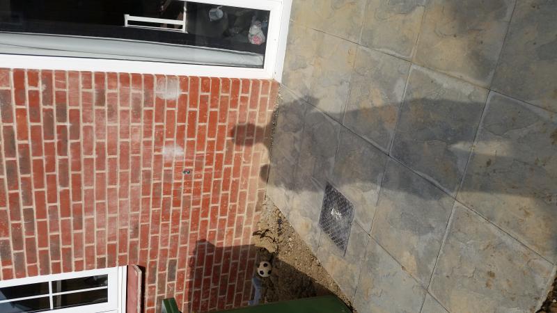

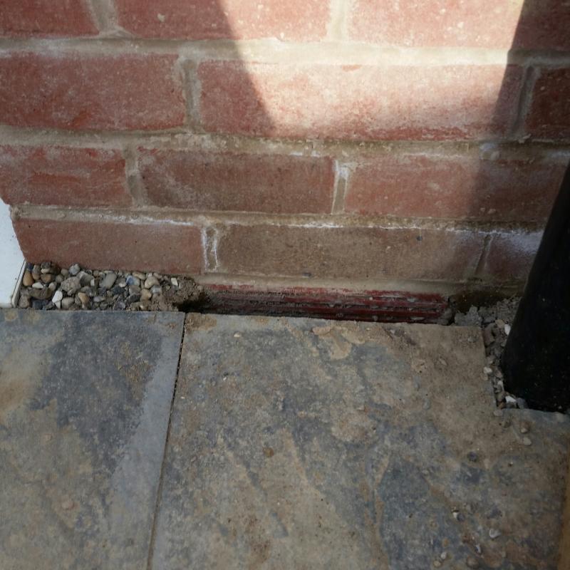

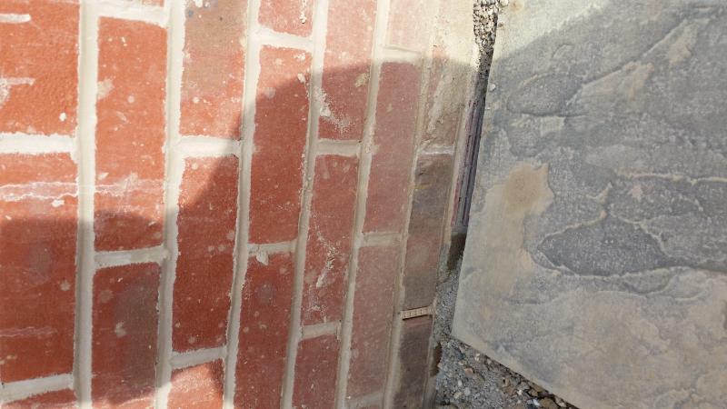

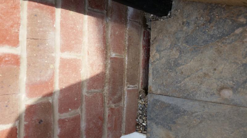

I have uncovered 2 air bricks underneath the patio that was laid when the house was built six months ago

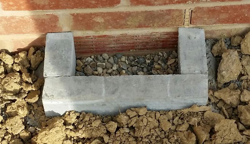

I have been in contact with the site manager and they have a solution of making a boarder to fit round the air bricks I've attached a photo from the one they have done so far which is underneath the kitchen window.
I really want to clear up whether it is okay to do what they have done as if I'm honest it doesn't exactly look great and when they do similar around the patio slabs I have a feeling it's going to look a whole lot worse
The only reason I can see is so that it is level with the rear door and possibly because of the drain cover that sits in the middle of the patio
OMG, is that really a new house? The wall is a bloody mess.
They may have also messed up with the paving level, which means you have that stupidity around the air bricks,
But more possible, if they knew the paving was to be at that level, then the air bricks should have been put in higher and ducted down to the underfloor void.
I would not accept their poxy solution, and insist that the air bricks are raised and telescopic liners put into the cavity. This will be a big job for them, but that is what needs to be done.

No - totally unacceptable and storing up problems for the future.
Either drop the ground level or raise the vents
NHBC Standards require the air bricks to be unobstructed. It is implied that the air bricks are located in such a position that they don't become obstructed - a dip in the ground does not satisfy this and in such a position they are prone to blockage and water ingress. So no, it's not acceptable.

the telescopic vents are In fact what are already in place which if I'm right would mean the only option is to lower the ground
They can fit longer ones - they are telescopic!.
IIRC, they will extend three course below DPC and two above - or can be adapted for more.
As the bottom half is already in, then it would be a simple job to open the wall and fit a top half extension and airbrick higher up.
The groundworkers are either clueless about brickwork or looking for excuses. Or both.
So it's either that or lower the paving. But then they have to deal with the raised paving at the door threshold, and you end up with a ramp
This definitely contravenes NHBC standards, and not only that, the NHBC issued what they call an 'Extra' on it a year or two ago. An extra means the NHBC have had problems with vents being in the wrong place so they issue extra instructions to make sure contractors do it properly. From memory it concerned exactly what you have there. Because they have to have a level threshold at the door it was easier for contractors to just continue the same level along the adjoining paving. The drawback is the vents get covered. They were instructed that this is poor practice and not acceptable - to NHBC. I'm sure if you ask NHBC they will let you have a copy of the extra.
