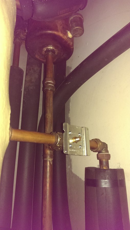

Here is the picture of the 3 port valve (actuator removed) with the Spartan ET50 Expansion showing an air vent connected to it:
Note I included a photo of the 3 port valve viewed from the top in an earlier post, if it helps...
The spartan et50 acts like a primatic cylinder in that is fills the heating system with the same water as the hot water cylinder, an air bubble then keeps them apart, I would drain down again and refill very slowly.
Despite having applied all the good advice from Tony, Daniel and Picasso, my boiler still shuts off after 45 seconds.
I noticed something very suspicious though, if I open the draining valve from the flow coming back from the boiler (i.e. the bottom valve in the above diagram), I would normally hear the water coming straight from the Spartan ET50 into the draining point (as it is supposed to fill the central heating), however I can hear the water dripping down at a very slow rate. When the boiler was used to work, I could hear and feel the pipes vibrating in this sort of situations.
-> Is there a way to rule out / bypass the Spartan ET50? It is so old it is no longer being made...
PS: I still haven't put back the actuator at the front of the 3 port valve, therefore I slightly loosen the 4 front screws and air escaped (only the first time). Since then, water now escapes each time I loosen those screws, which should mean water is coming from the Spartan ET50, though at a very low pressure but not sure if this would cause the boiler to stop?
