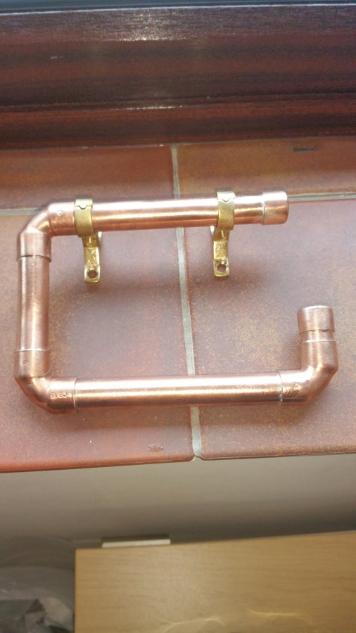

Hi,
I have some copper pipes on show and they have some cement and paint on them. It's gone on in the last 2 weeks. Any suggestions on how I can clean this up?
Chip off the big lumps with a chisel.
Your local supermarket sells 'Brillo pads'. Rub the pipe gently with the 'Brillo pad' and a little water until it's clean, then wipe over with a clean paper towel dampened with 'Brasso' and finish with a clear lacquer.
I like the green nylon scouring pads, used wet with water. You keep rinsing them in a bucket to remove gritty particles.
Get the person who deposited that stuff on them back to clean them. It is difficult to get that nice finish after they have been covered in cement.
Wire brush then patination oil.
That's how this is /will be done... All be it the wire brush was attached to a drill.
BTW I use Bakobrite/paste polishing No.5 to get the worst of the dirt/paint/scratches out, then finish with Brasso and a soft cloth. I use the kettle above daily and it's a nightmare to keep it looking like that.

What kind of finish do you want? Just cleaned up or polished and kept that way?
Big blobs of cement would need physical removal, screwdriver/small hammer to gently tap that off, the rest with wire brush attachment. Paint can be removed with solvents/sandpaper etc depending on how thick it is.
Polishing, then I'd use wire brush attachment as Dan, then change for a cotton buff pad, rubbing compound and wipe clean, then T Cut to polish. Brasso/T cut in the future to keep it that way.

Brick acid with a small paint brush to get the worst of the cement gone (USE GOGGLES!!), then wash down with plenty of water. Then a strip of fine emery cloth to get the right finish, perhaps finish off with some Autosol (good stuff)

Thanks for all the advice. As it happens, I have some patination oil and will give this a go tomorrow
