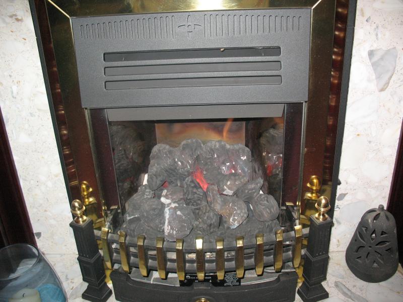

We have moved into a property with a potterton housewarmer and need a diagram of the coal placement, which potterton them selves cannot supply me with as the fire is no longer made! I enclose some photo's of it and would love some advise please! Thanks

The left hand photo appears to be the data badge for the fire, but the photo only shows the serial number. have another look t it, and see if their is a name?
Looks very much like 364 Inset LFE with PRESENCE FACIA - G.C. No. 32 59011
When the fire is cool, I'll take another look at that, but don't think I can get any cloer with my zoom camera than I have. I emailed Potterton/baxigroup and this is all they could say....

This is it http://www.acwilgar.co.uk/Boiler-Ma... HOUSEWARMER PRESENCE ASD GCNo.37-590-18.pdf. Unfortunately the info you need is on a separate sheet.
Wow thank you denso....so now I know that THIS is what I need!...
Install the Vermiculite, Ceramic 'Coal Bed' and Ceramic
Coals as shown in the instruction sheet titled "Installing the
Firebed Components" (Part No. 966/9350/3) supplied with
the ceramic packs
So anyone got instruction sheet 966/9350/3?
At last we have the sheet needed. I re emailed Potterton and they came up trumps this time! Thanks for all your help on here also! I now have a lovely full fire see below....
