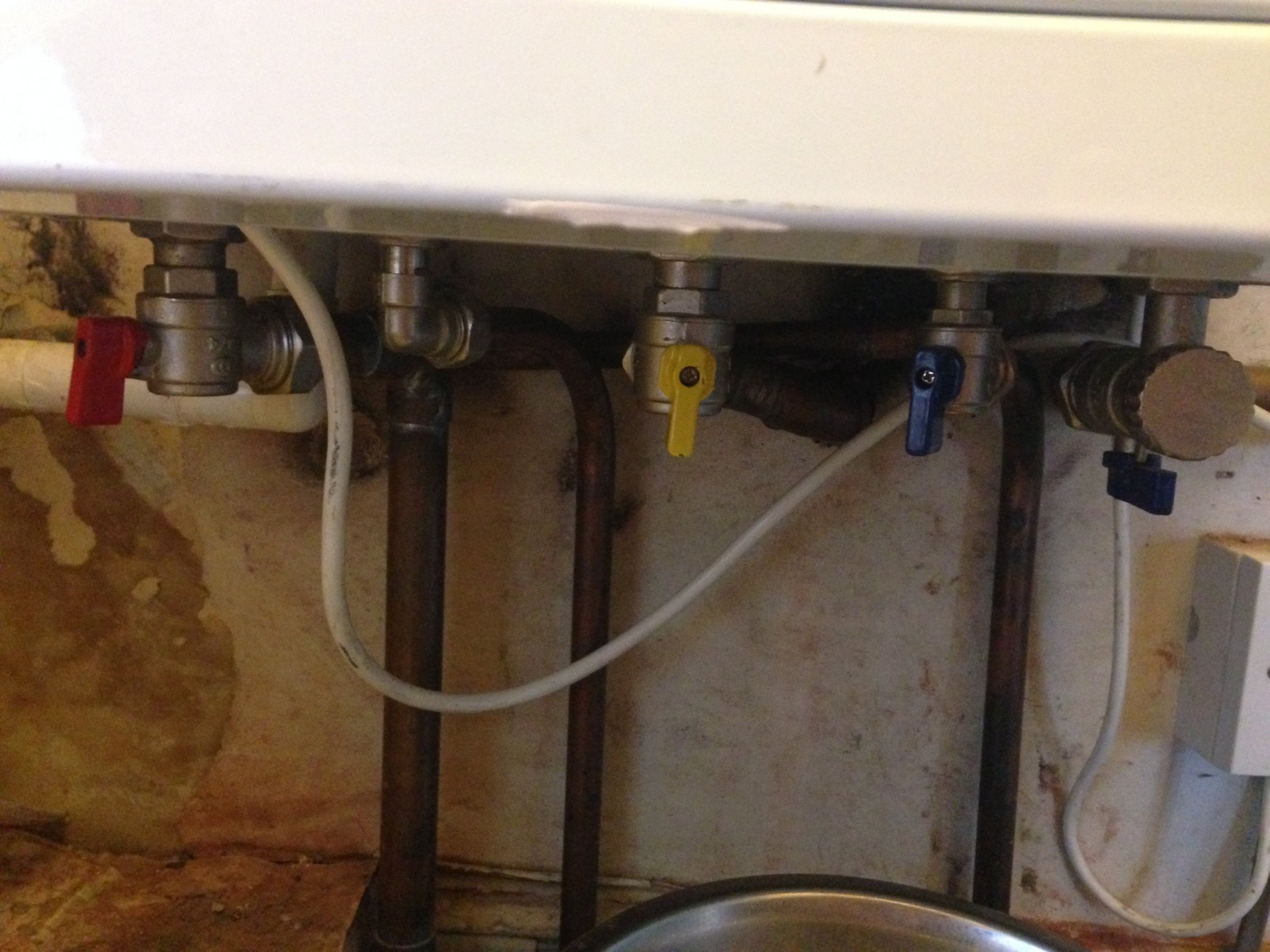

Hi,
My boiler is currently running at very low pressure and I have no hot water/heating. I've read about trying to top the pressure up with the filling loop by opening up the valves on the metal flexible tube.
Images I've seen have at least one black valve to turn. Mine doesn't - as you can hopefully see in the image below. It appears to have a thing that could be turned with a screwdriver where it might be.
Is it just that the valves haven't been fitted, should I go to work with the screwdriver?
//media.diynot.com/208000_207038_64994_50706729_thumb.jpg
Hope someone can help as I'd quite like to not have to get a boiler engineer out for something I could do myself.
Any chance for a clearer picture? I'm getting a neck ache..
From what you're saying, yes you'd be able to top your boiler pressure up with a flat bladed screwdriver - the best way to do it is open one up completely and then slowly open the other one - remember to keep an eye on the pressure!

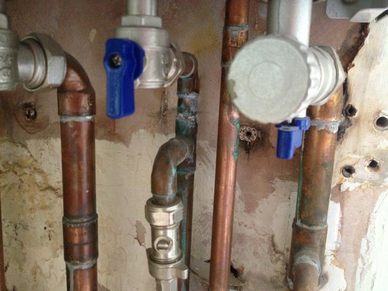

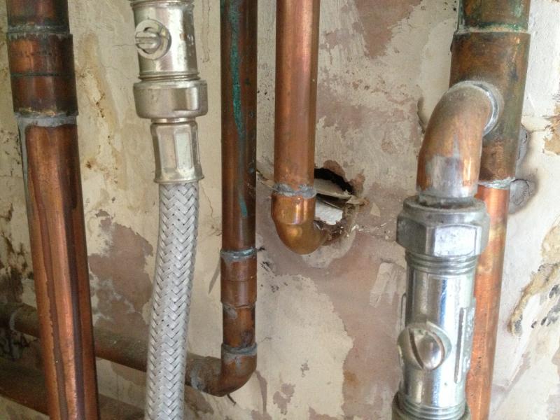

Yeah, sorry, I just realised how terrible that picture was when I looked at it again. I'll get something better for you now.
Here are some hopefully more helpful pictures.
Showing the bits I might be able to turn with a flat-headed screwdriver.
And the blue valves further up the pipes.
Hopefully this helps - does this change your advice?
Dont touch the valve on the right (thats a check valve) it looks like you can top up the pressure by just opening the valve on the left, make sure you put the screwdriver slot back in the same position you found it.
Thanks both of you, it's worked. Saved me a nice chunk of cash.
