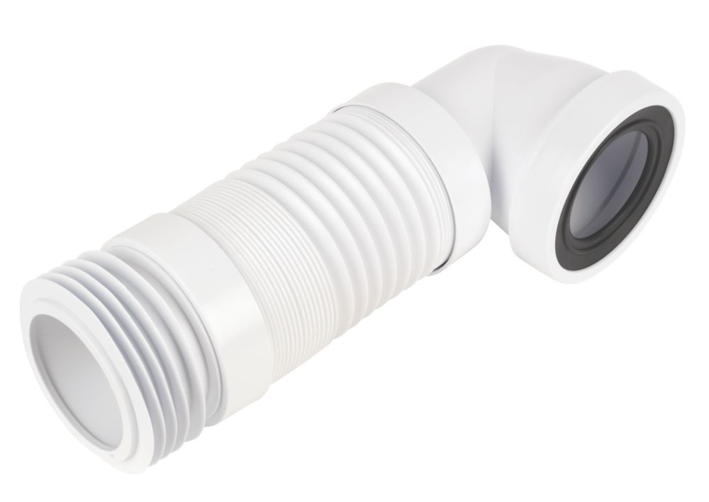

...just looking around for parts and I came across this:
http://www.plumbers-mate-sales.co.u...ector-reducing-extension---40005055-474-p.asp
mcalpine-4in-to-3-pan-connector-reducing-extension-40005055-474-p[ekm]300x300[ekm].jpg
Could I use one of these to get rid of the fernco or am I making un-necessary work for myself? I guess my worry is that the jubilee clip closest to the flexi connector may not have much to purchase on it. Or is the end of the flexi connector rigid underneath those fins, in which case the fernco may just compress the fins and make a tight seal?

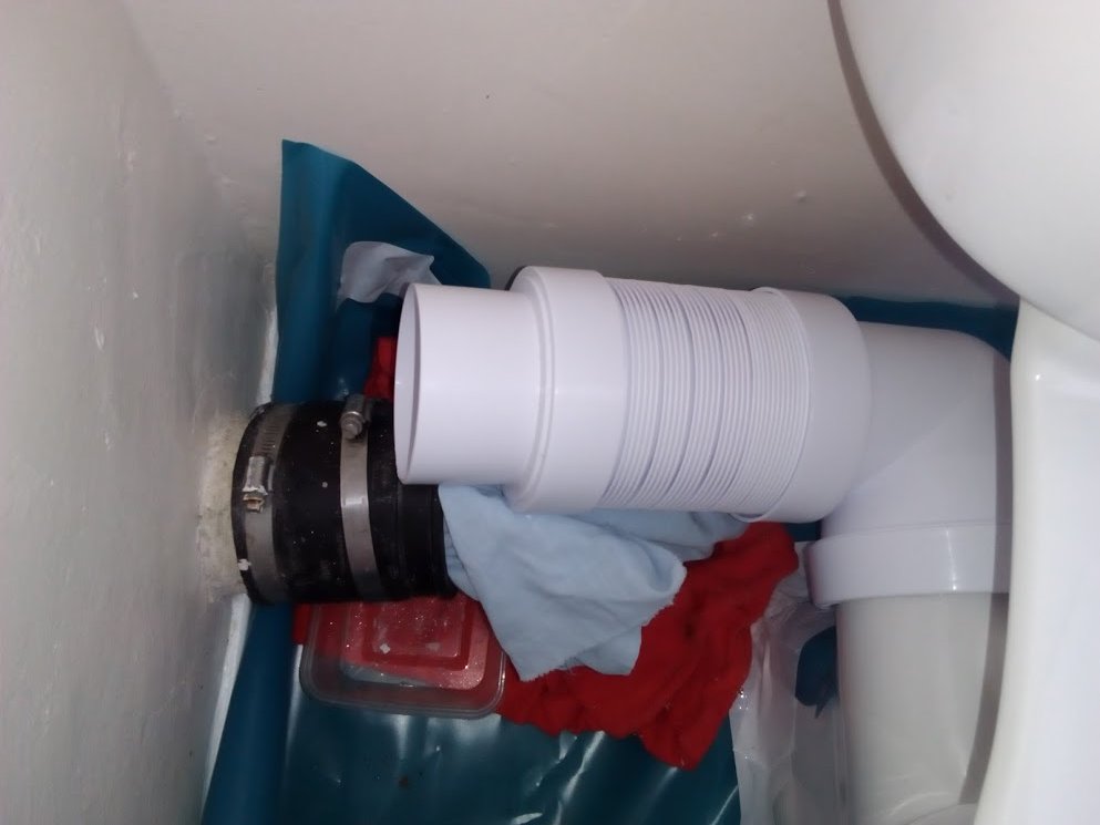

Okay, the good news is I have the old one off. The bad news is, despite it being a macalpine it was pretty much disintegrated - very nasty!
The problem, I think (see pic below - I've slipped the rubber fins off of the MacApline to try and get it into the fernco) is that there's just not enough room to use that particular flexible connector. There's not enough room to splay the concertina bits out to get the two bends in. I could probably force it but I think this is what the last plumber did, hence the fact that the old one just fell apart. I think it was too stressed.
Any ideas? The offset is about 50mm. I'm wondering if I can do it by using a space saver:
