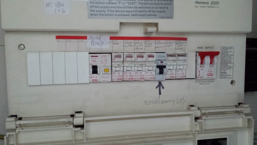

One of the C3 observations in an EICR was that there was no RCD protection on this consumer unit.
Is adding one as simple as replacing the main switch or another module, or does it take a whole new consumer unit?
It rather depends.
Replacing the main switch with an RCD is bad engineering and not recommended because a fault on any one circuit will cause the main RCD to trip, cutting off the power to the whole house.
The MEM MCBs that you have can be converted to RCBOs by adding a conversion pod to each MCB. But at more than £70 a circuit this is not a cheap option as a whole new consumer unit with multiple RCDs shouldnt be much more than that.
So the best option would be to have someone change the consumer unit. Is there a reason why you need to do this? The EICR should have mentioned the lack of RCD protection as a C3 - improvement recommended.
It was just that; a C3. If it were a very cheap fix I'd have it done, but replace MCB just to tick off a C3 is not worth it in it's own right.

I see your point, clearly there is one RCD but we have no idea what it protects or it's size. From the emergency lights and sump pump labels the latter seems to be supplied from a 16A RCBO it would seem this is not domestic. Once we move to industrial supplies we need to consider who is in charge, it may have an electrician and it could have surface cables and RCD's at the destination rather than origin.
