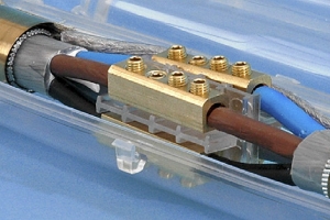

The resin pack came with metal butt connectors.... I can't seem to get a good crimp using them, they seem too big. The cable is 4mm2 and the pack does upto 10mm2. Is it normal to double up the cable to get a better crimp or better still is there a connector I can use without crimping at all. Seems a bit daft buying a new crimping tool to join 3 cables.
Ideally one of these plastic choc box type, with the screw connector. but obviously not sure they deal with this kind of voltage? Do they do ones suitable? Rest of it is relatively straight forward.
Voltage isn't a problem, but I'd be wary of using that sort of connector in something as inaccessible as a resin joint. Will the resin properly encapsulate the screws to guarantee they never come loose? Compare the screwed connector in the photo above and you'll see the difference.
