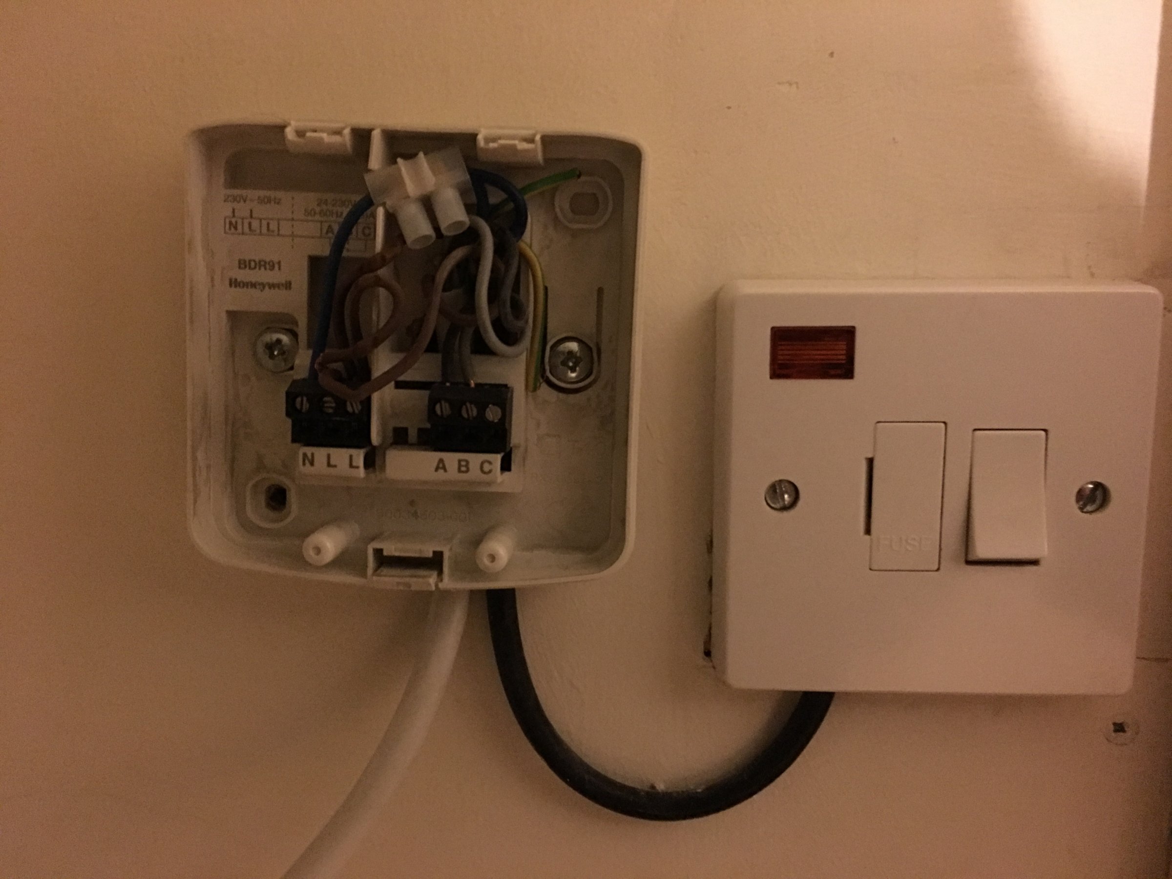

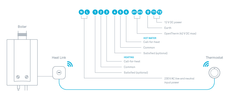

We've got an Ideal HE 35 boiler going into a Honeywell BDR91 wireless relay box and looking to swap this out with a new 3rd gen Nest heat link. I've taken the cover off the relay box and can't figure out the wiring and how it would go into the heat link. Was wondering if I could get a bit of guidance?
This is what it looks like at the minute:
And I want it to go into this:
Photos aren't brilliant so this is how it's wired up
Black wire from power supply:
Live wire goes to middle L
Neutral wire goes into choc box one side and into N from other side
Earth goes no where
White wire from boiler:
Black (neutral?) wire goes to A
Grey wire goes to B
Blue (neutral?) wire goes into choc box one side and into N other side (as above)
There's a Live wire "loop" going from middle L to right L
Earth goes no where
I don't know why there's both a black and blue wire as I thought they were both neutral?
Any help much appreciated
Many thanks
Phil
Who crushed all the wiring in like that? :mad: The insulation is damaged and can't be used again in the condition it is in. Also the earths are not connected! :eek: There is also a link between the 2 Ls which isn't required as the link is already made internally.:)
Ah, sorry, didn't look at it properly, yes the two L terminals are internally linked, L to A isn't. It's been a long day!
:LOL:
I was just about to post a pic of the installation manual showing the internal link! So here it is.
Live wire goes to middle L : Connect to L
Neutral wire goes into choc box one side and into N from other side: Connect this one to N
Leave both blue neutral wires in other side of terminal block
Earth goes nowhere: connect to earth terminal
Black (neutral?) wire goes to A: This not a neutral - connect to 2
Grey wire goes to B: Connect to 3
Live wire goes to middle L: Connect to L
Blue (neutral?) wire goes into choc box one side and into N other side (as above): See black wire above
There's a Live wire "loop" going from middle L to right L: Ignore it
Earth goes nowhere: Connect to earth
I would also want to check that the earth wires at the other ends of the 2 cables are also properly connected.
