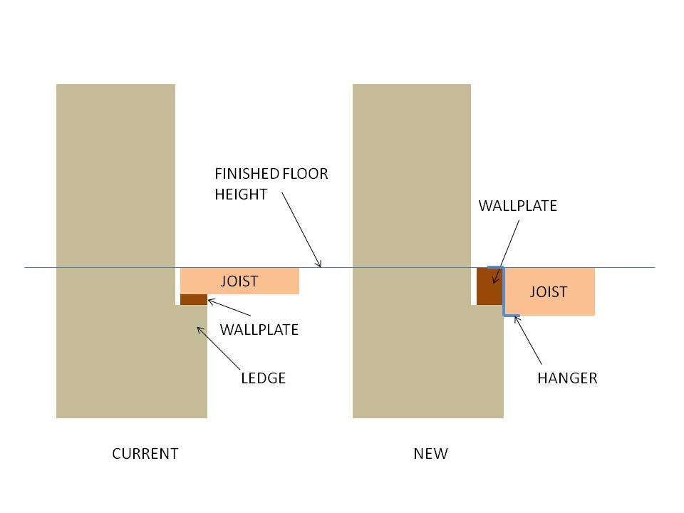

However, when I replaced the joists in the similar sized back room with like for like, there was still a bit too much 'give', therefore I'd like to beef this up a bit and go for 50x147. Unfortunately, the joists sit on a plank of wood (wall plate?) on a stone ledge 100mm below the floor surface so if I were to rest the joists onto the wall plate, the floor would be too high.
It's part of a total back-to-bricks refurb of this room so I have a fairly clean sheet to work on. My thoughts are to fix 50x100 timber along the ledge (effectively a tall wall plate) and hang the joists off this (see diagram).
Questions:
Is this a sensible way to do it?
What sort of joist hanger should I use?
Is there another way?

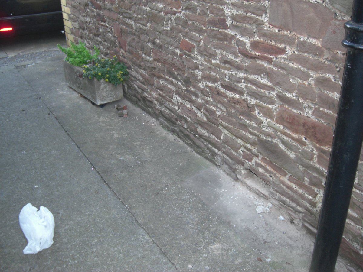

9. Pics of a larger view of the room and outside showing ground level would help.

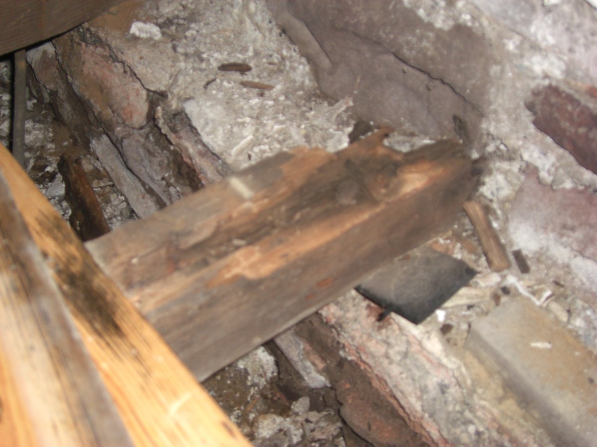

I've edited the previous post; the end of the joists at the internal wall are also on a wall plate but seem fairly good condition. Photos to follow.
Mike

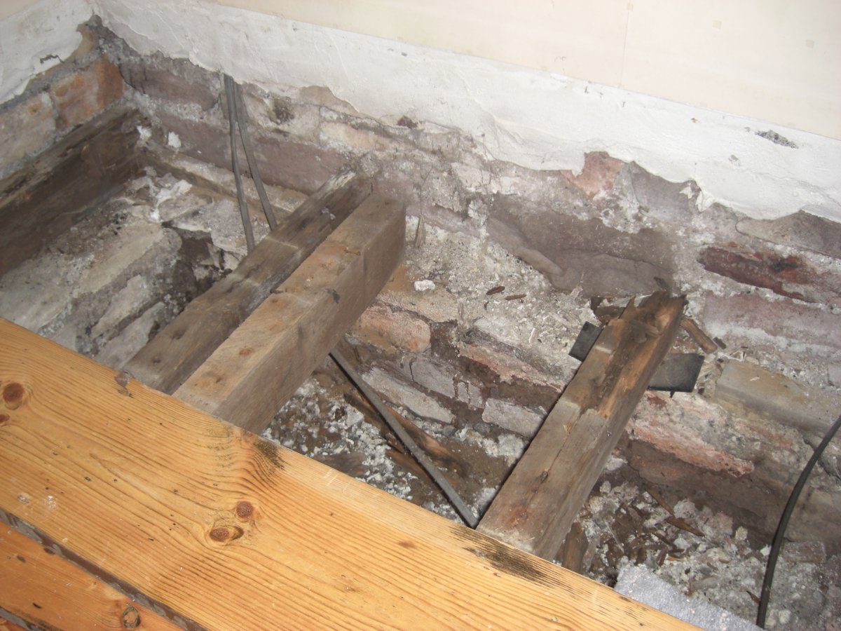

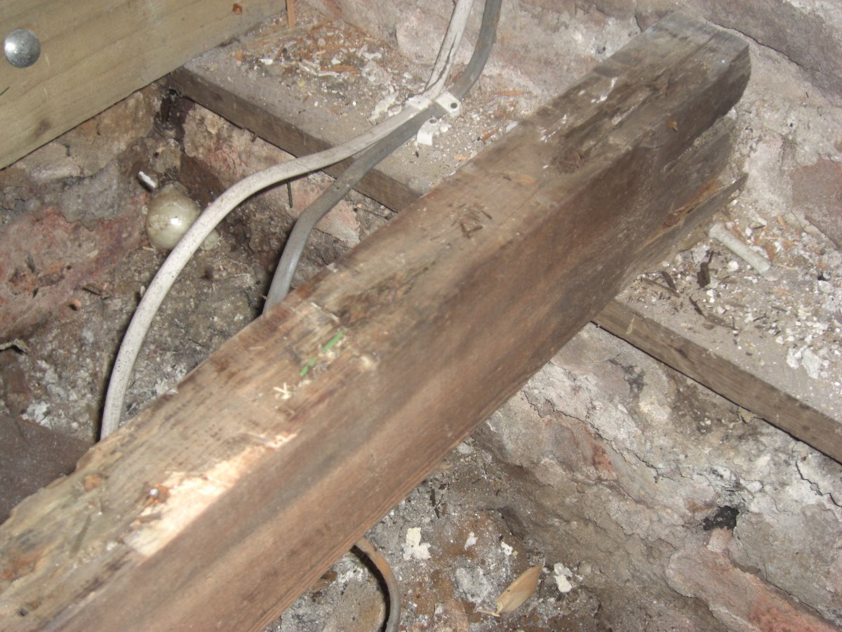

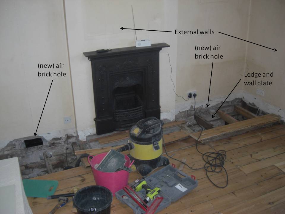

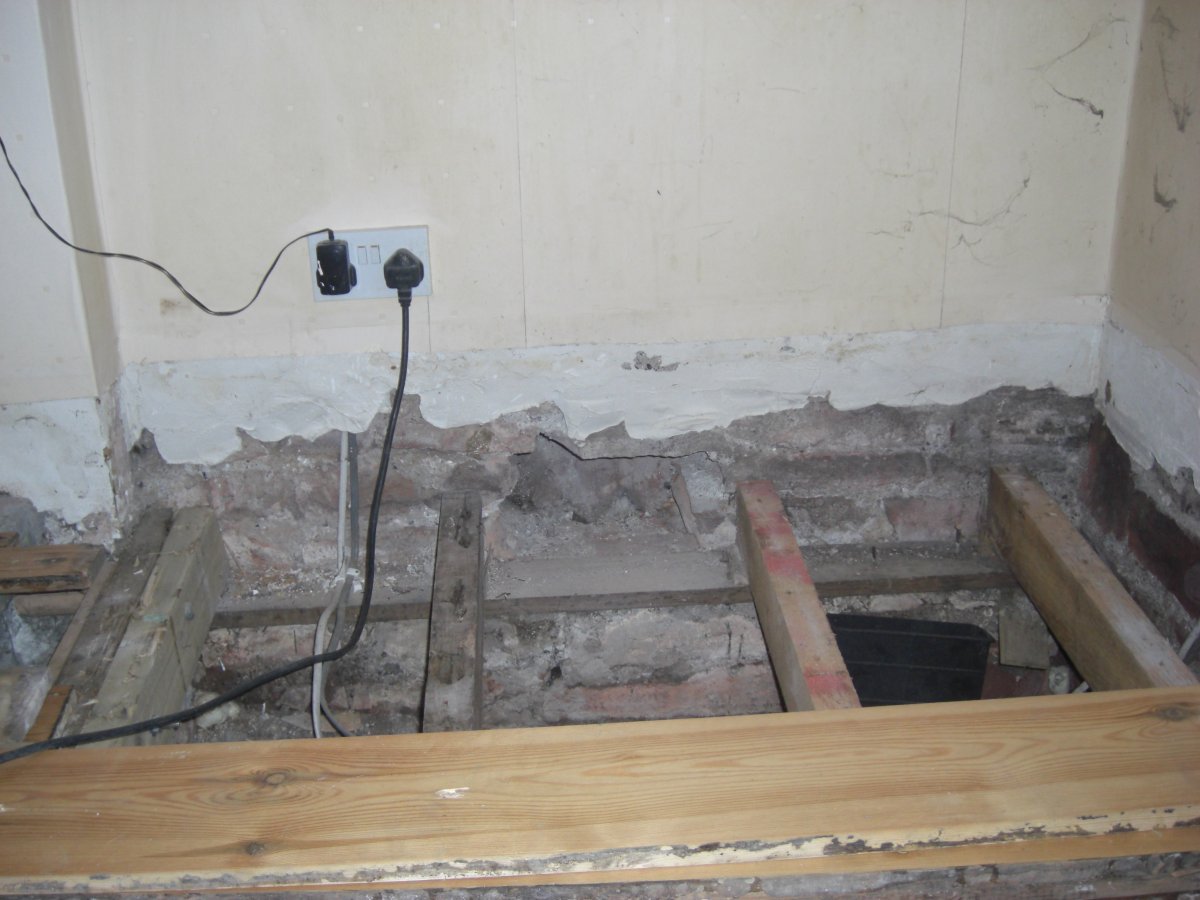

Some photos to educate, inform or shock...
General view:

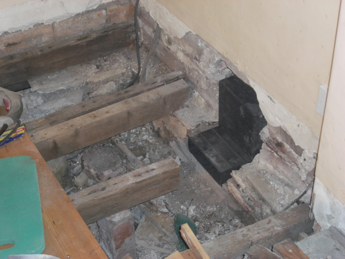

Joists to left of fireplace
Joists to right of fireplace. Note new(er) wall plate and two replacement joists. They've been in for approx 25 years and seem good condition. CIMG0301.JPGCIMG0291.JPG

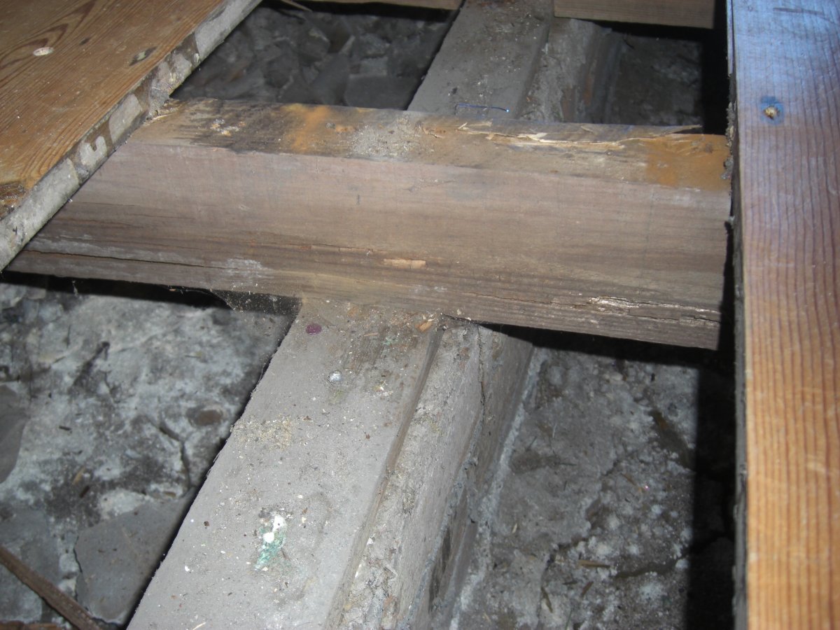

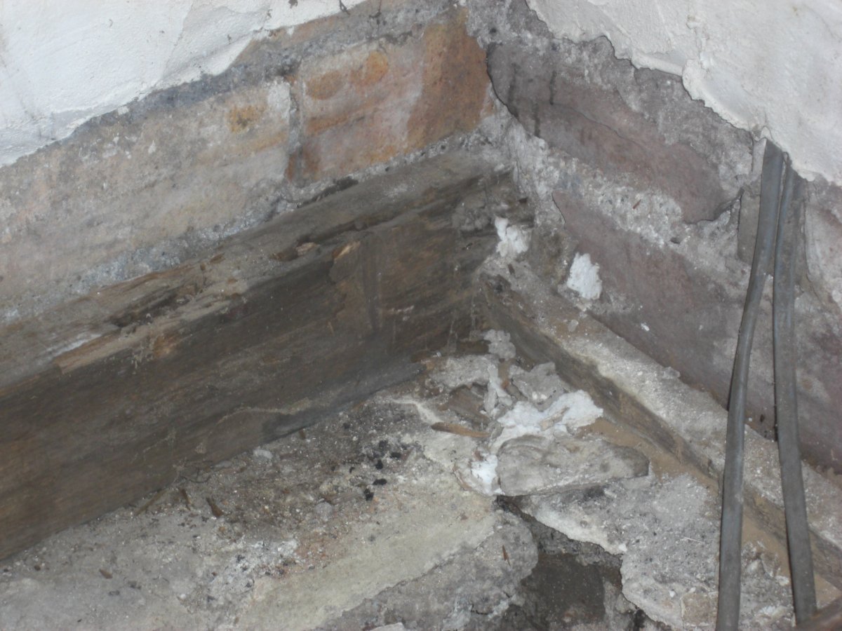

Joist crossing sleeper wall in middle of room.
A sorry state... :(
Mike

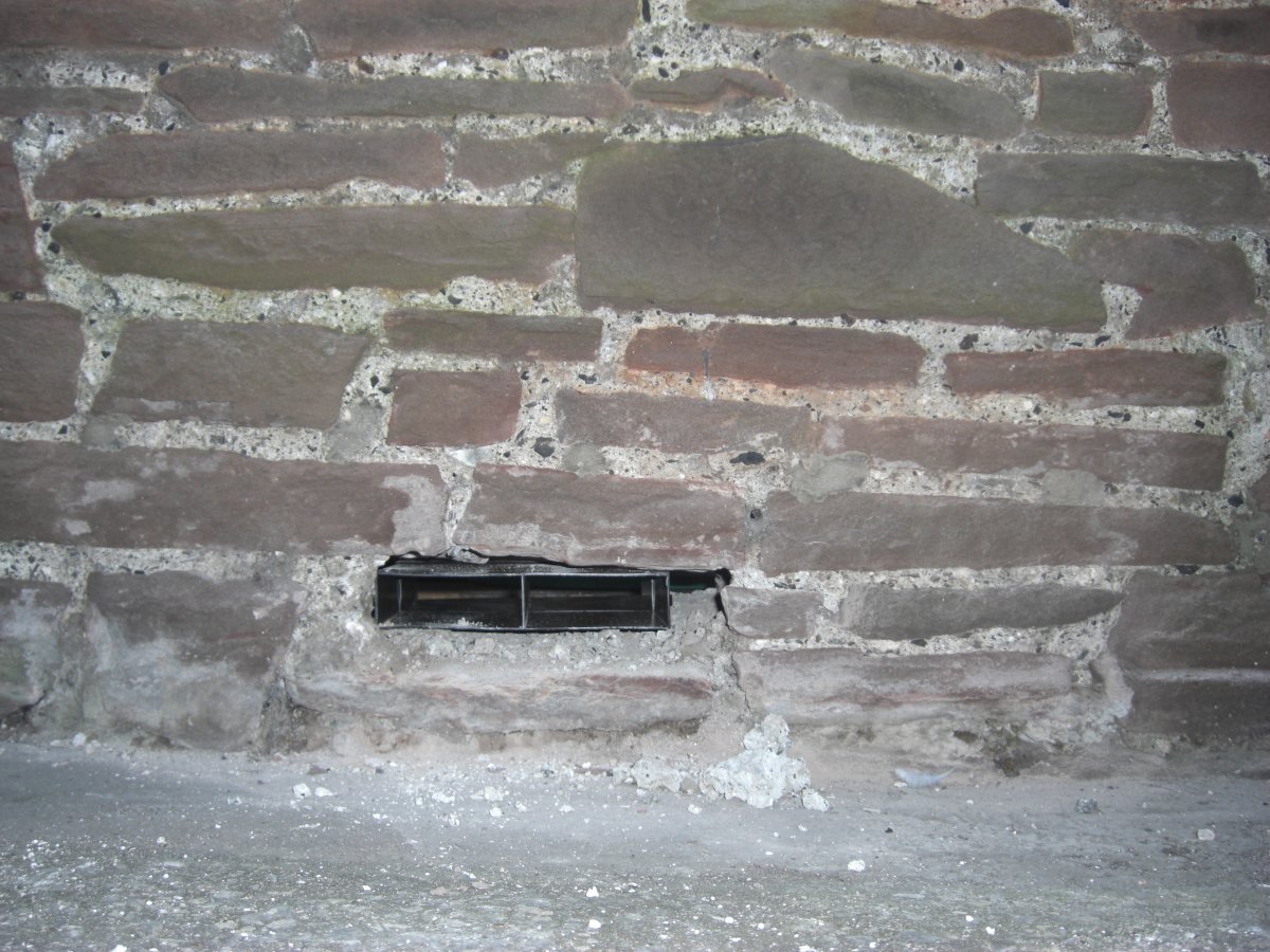

Air brick hole viewed from outside

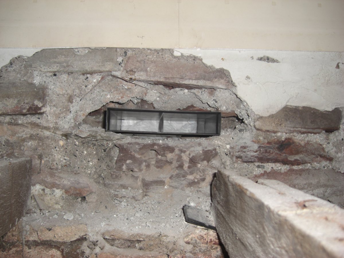

and inside
Note driveway and top of joists are at similar level.
Periscope air brick recessed into wall and ledge (to go under wall plate).

Thanks for the annotated pics. With the new information, here's what i would do:
10. Lift all the floor boards in the room.
This will enable you to see the full extent of any rot and also enable you to replace damaged joists.
11. Remove the remaining sections of wall plate and rubble on the ledges. Wash down with anti-fungal chemicals.
12. It might be in your interest to replace complete lengths of joist rather than do tie-ins & bolt-ons.
13. Use 300mm x 30m rolls of DPC to cap the joist ends and wrap the joists that are tight to walls with 300mm DPC - protecting them from masonry contact.
14. Protect from any masonry contact the new sections of wall plate (wrap with 300mm DPC), and bed the wall plates level on to the masonry ledges - similar to what you have now.
15. The joists can be pinned to the plates by Ell brackets.
16. Use Simpsons HSA Joist Struts at appropriate intervals.
17. An intermediate wall/plate/joist pic shows signs of decay - its probable that the plate must be replaced (bed the new plate on a DPC). The rotted joist, & perhaps other joists, must also be replaced.
18. Post pics of the exposed hearth area - its probable that remedial work (the trimming joists) is needed there. Has damp been an issue on the chimney breast?
19. In pic 6 - to the left of the cable - there is a white shiny object: what is it?

Ree, many thanks for the comprehensive post. I'll provide more detailed answers later, but all timber will be replaced and the hearth will be removed entirely.
However, you seem to be suggesting a wall plate with joists resting on it (ie as original) but this doesn't allow me to increase joist depth. Or have I missed something?
Mike
I understood that you didn't want to increase joist depth. I was wrong.
20. However, if you do then dont use any wall plates: hack into the masonry for pockets - you've managed to do it for the venting.
21. Or, simply rest the capped joist tails on the ledge & use Joist Struts within 400mm & 1000mm of the bearing.
22. Drop by one course all intermediate knee walls.
23. Post pics of where the next room knee wall meets the old floor - presumably the joist tails cross?. Are the rooms knock-thro's?
24. When all joists are fixed and level, and most chipboard is down (but leave off the last sheets near the external wall) then test the floor for bounce.
Ree,
Q19 - it's a bit of discarded expanding foam. Not mould or fungus (although that wouldn't surprise me if it were)
Q18 - no damp on the chimney breast; the chimney has been removed at top floor ceiling level so there is a hole exiting into the loft. With the gaps around the previous (decorative only) fireplace, there would have been some airflow.
Q23 - there is no knee wall in the adjoining rooms (a hallway and a study) as they are small enough to span with single joists, the ends of which rest on ledges, not pockets in the wall. This is the original room design, not knocked through.
Regarding 11-17, this was roughly what I planned to do, ie remove everything and use DPC between any wood and masonry as you suggest, lower the knee wall by a course, use herringbone struts etc.
However regarding using deeper joists, removing the wall plates will only give another 15-20mm joist depth and I'm loath to hack into the ledges to support anything structural as it is difficult to get exactly the bit out that needs to come out without disturbing other stones (hence over sized holes around the airbricks). I also foresee problems around the hearth as I've yet to dig it out to see what is underneath that could support joists - currently lots of crumbly wood on damp clinker/ash.
I was thinking it would be easier to get a wall plate level and work from that. Is there any reason why my original suggestion ie a 'thick' wallplate and joist hangers, using DPC and new timber is a no-no? I was thinking of something like this http://s7g3.scene7.com/is/image/ae2...1,281&layer=1&size=281,281&src=ae235/37986_A3.
I've got a bit of time to work it out; I need to pull down the ceiling and knock off plaster before I lift and remove the floor completely, but suggestions and advice very welcome in the mean time to help me plan it.
