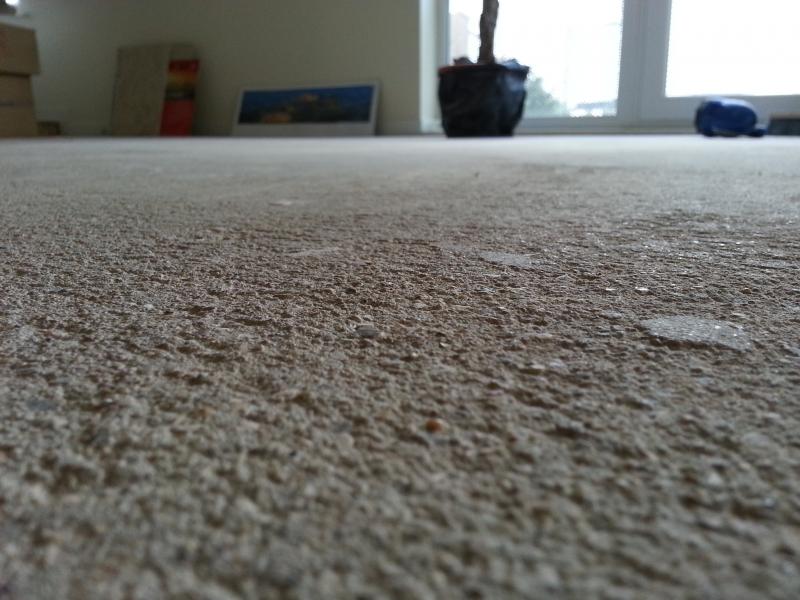

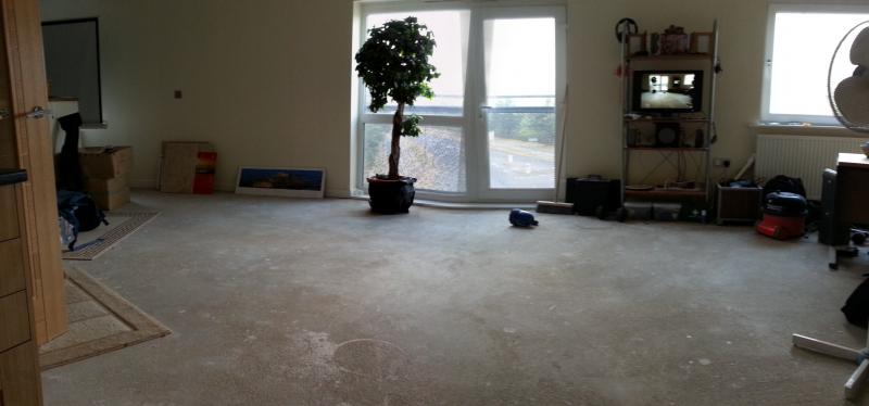

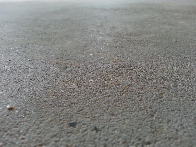

I'm not a builder but I do realise that something needs to be done about my bare concrete floor before I go putting anything more on top. The amount of dust it generates is nothing short of incredible.
What is the best way of sealing this? - I have heard different things from different people, everything from waterproofing paint to various oils.
Would I be able to paint it with an epoxy product to make it reflective afterwards? - Would this be inadvisable if in the future I decide to carpet it over?
Advice is much appreciated if you have any experience of this.
Screenshots below:

Top floor
