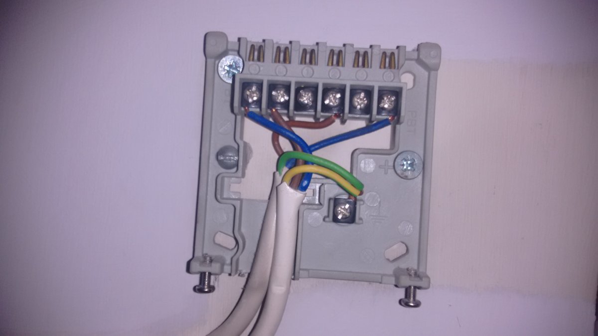

Hi Everyone,
Could I please have some advice on changing my RWB7 to use a Wireless Digistat +3RF and receiver, the back plate is the same size I have a neutral and live then a live in 2 and neutral in 4.
The Drayton shows neutral then live then common(1) then call for heat(3), am I right to think I just need to move live from 2 to 1 and the neutral from 4 to 3 to have the wireless receiver working?. This is what I have now. The Boiler is a Worcester.
This is Draytons wiring.

Money is very tight so any advice would be appreciated

Hi, thanks, but it was a supposed to be a professional plumber who installed this system 10 years ago using thermostatic valves, which are not very good, do I assume then that he just used whatever cable he had and that's why they are not live or neutral?. I'm tired of being stung by electricians and plumbers. Twice now ive been screwed by them for work
I know the neutral and live are correct so I need to know where the other two go please. I assume as this is a DIY forum this is the point of not having to pay someone £100 to connect two wires.
Thank you
Update: I was right, moved 2 to 1(common) and 4 to 3, everything works fine, it just took some reading, thank you for your helpful advice. :cautious:
