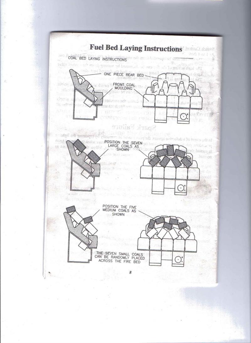

I’m looking for an operator’s manual to help me set the coals for this fire. I know the exclusive fires no longer trade but someone must have a manual but I’m having no luck finding one.
I have a user manual for this fire. I can e-mail the coal configuration if you still need it.

But the inset supreme is a DFE and therefore requires minimum of 100cm2 free air unless stated in the MIs,
So does anyone know what is stated in the MIs?
