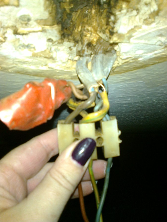

My mum wants her lounge light changed. I took down the one that was up so that I could see if it would be straight forward for me to swap it over.
Technically, the way it is looks like it will be straight forward for me to put the new one up, but I just wanted to check if the way the existing wiring is, is safe - block connectors and insulating tape. :confused:

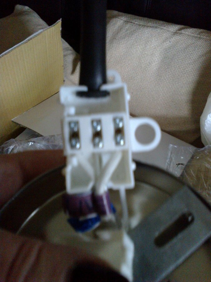

I've attached a pic of the connections on the new light fitting too.

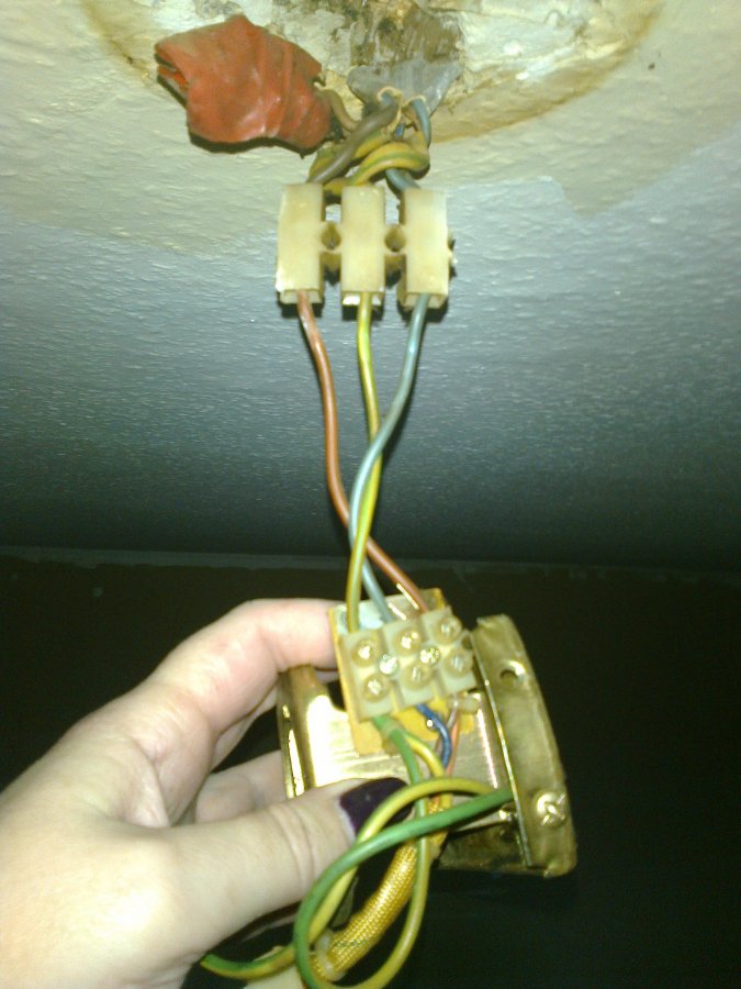

Also, I couldn't lift the old fitting back up to re-attach it - it's too heavy, so I've had to just leave the wires as in the pic - is this OK temporarily? Nobody is going to be touching them
No not safe,
Use one of these to replace the three way terminal block and the terminal in the red tape.
https://www.tlc-direct.co.uk/Products/ASJ501.html
or one of these
https://www.tlc-direct.co.uk/Products/ASJ804.html
Then the box can be pushed through the hole in the ceiling with a three core flex coming down for the new fitting. Mark the wire ( the Switched Live ) that is connected the the brown from the lamp so it doesn't get "lost" when you change the wiring

You will need 4 connections and just copy what you already have. Those covered in tape, into one connector on their own, then just use the other 3 to replicate what you have, and use a bit of flex if you have it, to connect onto the new light connector.

The connector supplied with the new fitting isn't really suitable to connect that bunch of wires directly to, and an additional connector block is required to accomodate that bunch of brown wires, known as the loop.
For the convenience of the op, I would suggest using 'standard' 6 amp connector blocks, instead of that supplied connector, and wrap them up with insulation tape.
I would also encourage the use of an overlapping BESA box lid placed between the ceiling and the light fitting - to provide the connections with an enclosure.
A 20 mm or less hole is required in the lid to allow the cables to enter.
A round plastic pattress is also available to house the connectors.
The browns goes into a seperate block all together on their own.
The blue with the brown sleeve goes to the live of the light.
The remaining blues go the neutral of the light.
The green and yellows go to the earth of the light.

Thanks for the replies. The first block connector barely fits in the hole in the ceiling and I wouldn't want to make it any bigger.
As it stands, mains wires go into block connector, then there's live,neutral and earth wires coming out and currently going into a second block connector (which I don't think I need) - these three wires from the first block connector could just go straight to the light?

Sorry if I'm being thick - just want to check what I'm doing - the connector from the mains cable is staying in the ceiling and then I'm putting a BESA box lid on the ceiling and bringing the wires for connecting to the new light fitting through it? I take it I need to make a hole in the lid for the wires to come through?
Yes 20 mm hole as said, all connections would be between the box lid and the light fitting, this way all the connections are enclosed.
