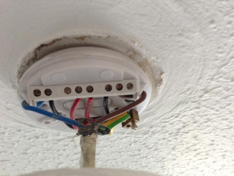

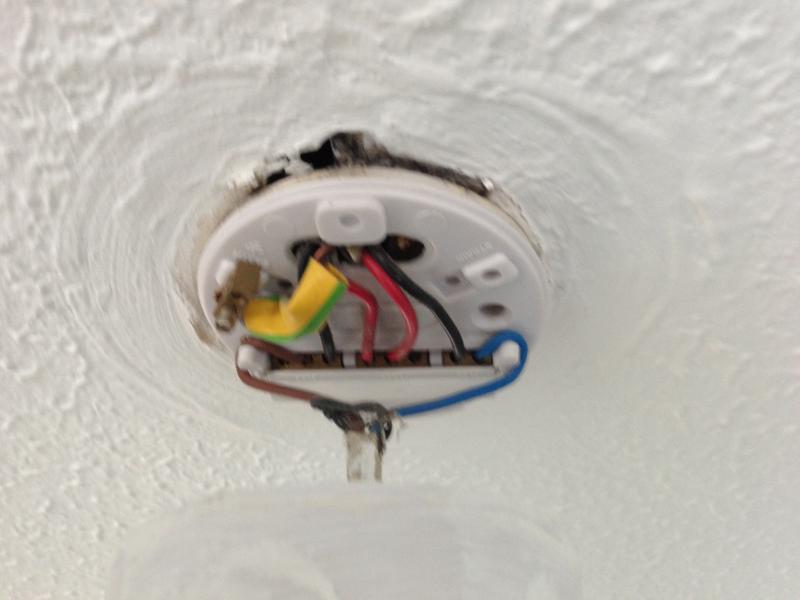

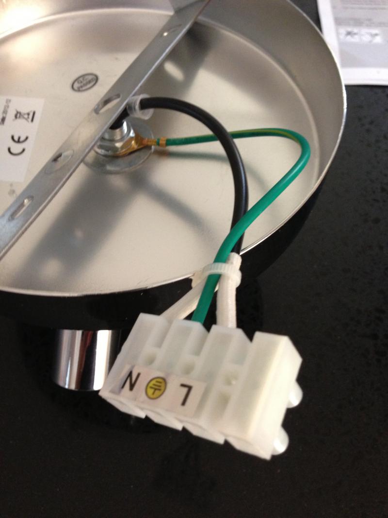

Hi everyone,
I've been trawling through the forums for hours trying to find the correct and safest way to fit my new light fitting, replacing the older standard rose ceiling lighting. Apologies if this has already been posted elsewhere, but everything I read seemed lightly different to what my set up appears to be. Any help would be much appreciated. I've attached pictures of the old and the new:

I know that there are essentially two batches of wires containing 3 wires each (earth, live and neutral?). I'm not sure about how to connect them though...[/img]
quite easy, as long as you don't mix the wires up!
Switch the consumer unit off or at least the light circuits at the CU.
Take the two red wires in the middle joining block out of the back of the rose, and connect that to the spare/empty connection on the end.
Take the black wire out the back of the rose which is next to the blue, and connect that to N.
Take the remaining wires out and get rid of the rose.
Put a bit of red tape round the black wire and connect that to L.
Connect earth green/yellows to earth green

Wow, thanks for the super quick reply!
So with the two reds in the middle (part of the loop system? Because there are only two, does that mean it's the last light on the circuit?), the wires are ok to touch and go into the same spare bit on the new lighting block? Or should I put one wire in one end, and the other one in the other end?

You can put the two reds however you like. Whichever is easier for you to do. Andy has it right apart from one thing I'd suggest. Don't just knock the mcb off that controls the lights, knock all the power off. Best done when Emmerdale is on!! ;)
It's exactly like the Dining Room light in the first drawing here: http://www.diynot.com/wiki/electrics:lighting-circuit-layouts
No. http://www.diynot.com/wiki/electrics:lighting
http://www.diynot.com/wiki/electrics:rose

Thanks, I did see that, and generally found there were so many different setups, I wasn't sure which was most applicable lol.
Anyway, thanks to Andy and Scoby for the quick replies. It was good to just get a bit of reassurance regarding my exact case. I got the lights up and running just right :)
