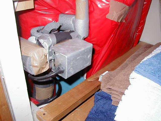

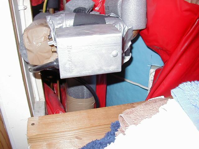

I've discovered my valve works as follows:
heating only on - no problem.
hot water only on - no problem.
heating AND hot water on: heating works but hot water does not heat up.
Is this normal?

Difficult to tell from the pics, but is the valve a three or two port - see pics?
Must be being dumb but.... the two pics look the same! How to differentiate 3 port from 2 port? Both pics seem to show a pipe with a joining spar (supply?) with a control box sitting on top.
Easy. 3 port has 3 pipes going to it, 2 port has 2 pipes.
Am I the only on that can see 3 pipes going to the valve in the photographs?
