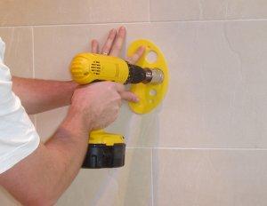

Drilling tiles
Ok, so you have your nice new tiles firmly stuck to your walls and floors and now you want to start fitting things like soap dishes to walls and toilet pans to floors. So you'll need to drill some holes.
How you go about drilling holes depends on the type of tiles you have.
If you have regular ceramic tiles, you should have no problem using a masonry drill bit (preferrably one in good condition). Mark out where your hole needs to be, then put the drill onto the centre of the mark (the drill isn't spinning at this stage). It's important to ensure that the drill is square to the tile face or else it will wander when you start the drill spinning. Once you're happy that the drill is square, start the drill spinning (not on hammer action) but very slowly at first (so it's only just moving) - at this point you're just making sure that the drill is staying in one spot. If it starts moving about, stop and re-position it. Before long the drill will bite into the surface of the tile - at this point you can increase the speed. Once you are through the tile itself, you can if you wish, turn on the hammer action if you have a solid wall to drill into. Do not attempt to drill through tiles on hammer action.
If you have a harder tile such as porcelain then you're going to struggle with even the best masonry drill bit. They will go through, but the problem you have will be that the drill will overheat very quickly and will stop cutting. There is a way of using a masonry bit with porcelain tiles but it only really works on floor tiles - this involves building a small wall around the area (with plasticine) and filling it with water - you can then slowly drill your hole and the water will prevent the drill from overheating and "burning out". This is not the ideal way of doing it, but can get you out trouble if you've lost your diamond bit.
"A diamond bit" I hear you say! Ideally, for harder tiles, you want to be using a diamond drill bit - this is essentially a tube with crushed industrial diamonds stuck around one end. These can be quite expensive if you were to buy them at your local diy store, but the option to buy them cheaply from overseas is there. Some of the pro tilers on here use this site and say that you will receive them within the week.
For ease, you can get a guide that will allow for easier alignment of the hole. If you get someone to apply water to the drill bit while you drill, the bit will last longer. Be warned, you may only get a two or three holes out of a drill in very hard tiles.
Using wall fixings
You should have no problem just using a regular wall plug (rawl plug) - just make sure that when you push the plug into the hole that you use a hammer and a screw to tap the plug into the hole so that it's about half way through the tile. This will remove the risk of cracking.

Drilling tiles
