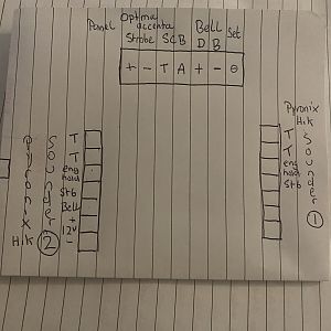

Good evening everyone , I am new to the forum and am looking for a little help from if possible from an alarm expert “guru”out there, I know the general wiring of the alarm but I am stuck with wiring an additional sounder , mainly the 2 tampers on both sounders I have included a diagram of what I wish to wire up.
The panel is a optima accenta ( Honeywell) and the 2 external sounders are pyronix hik vision.
Any help would be very much appreciated
