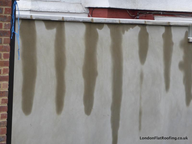

Bridging of drip detail parapet wall
steveroofer
This is a new wall and the coping stones have been bedded on cement and that cement and the pointing between the joints is bridging the drip detail
coping stones and parapet walls
