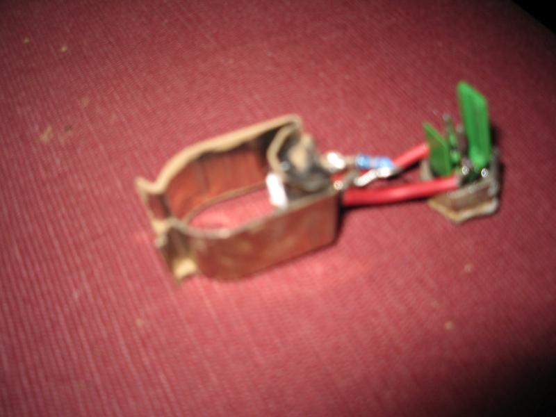

Central heating sensor
The old one broke off, and I was too chicken to dig it out. Made this from a clip-on one, with a parallel resistor and a science experiment (ice, boiling water) to get the resistance right.
