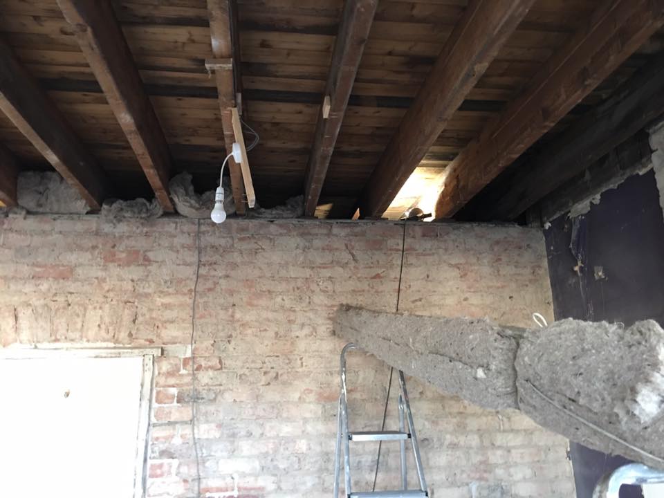

Pushed 140mm wools insulation between the joists above landing
2/3 of roof is flat. Front 1/3 is pitched. This is how I used long 4x1 battens to push the insulation above this space (approx 4 metres deep). There's a slip knot in the end that I pull to release once its been wriggled into place.
