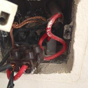

Yes, that's the bare cpc from a T+E with 'insulation tape' covering it, feeding a spur from a rfc and not even an attempt to take an earth to the socket
