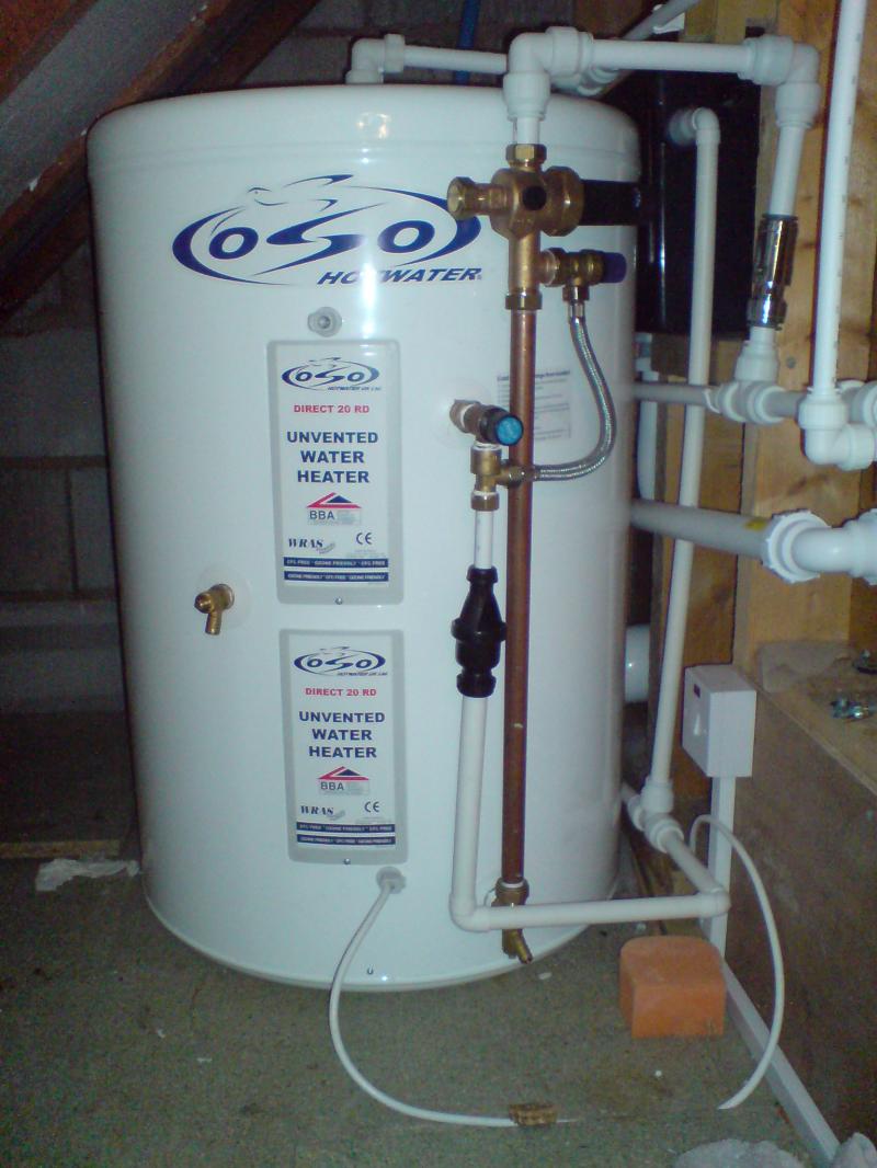

I found this unvented direct cylinder fitted totally incorrectly by an unqualified 'odd job bloke'. D2 pipe was run in overflow pipe, connected with speedfit tee and joining overflow from the WC next door, straight through the eaves and discharging above head height!! OMG!
