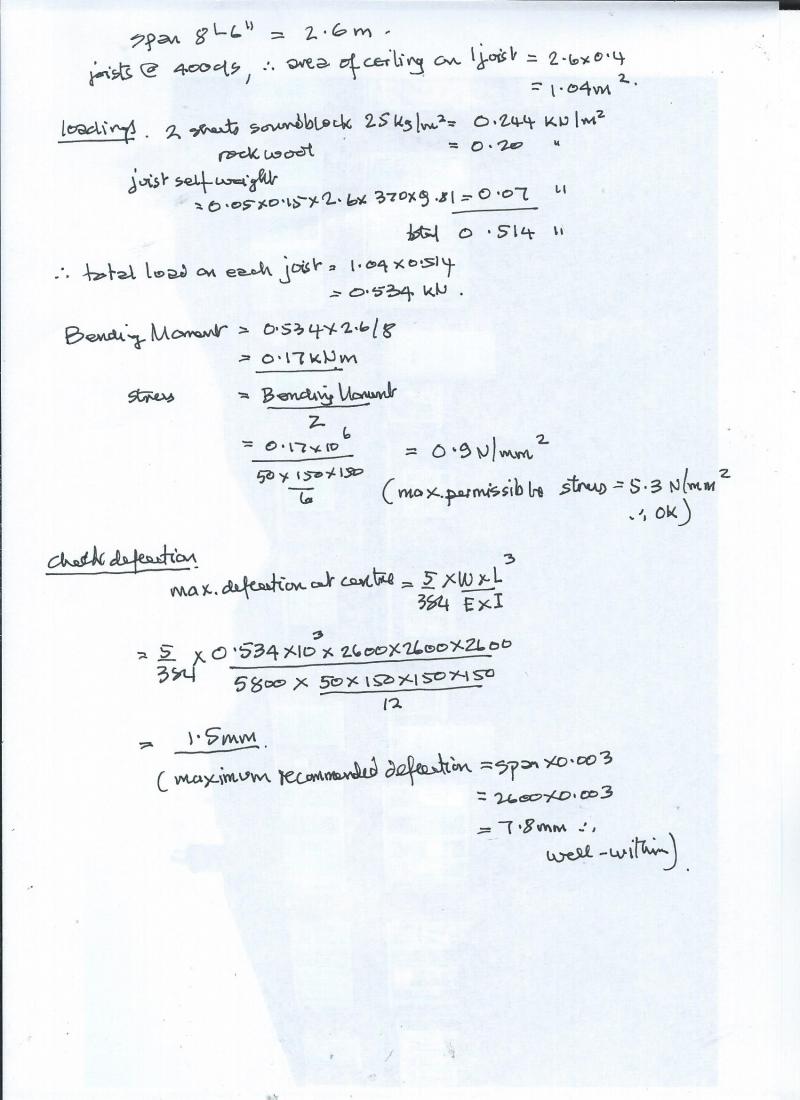

tony1851
Calculations
tony1851
621
81 KB
800px x 1100px
