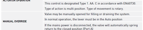

    Yes, I would think off terminal 10. There is AFAIK, no auxiliary (end) switch on these valves, the only way I can see it failing in the...

    Slight hiccup?? The pipe where the 24.7C sensor is attached to is the GAS inlet I'm pretty sure and the Boiler Return is most certainly...

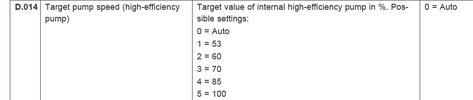

    I'll list out what it said below. Though first worth mentioning I set the A2 to 0 and it still did the jumping from 20 to 80% thing once...

    Let WB worry about the (if) 3 way valve. Write down or take a snapshot of these (especially temperature values).
