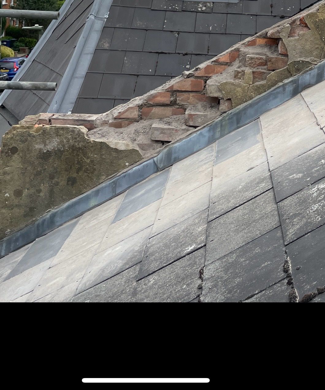

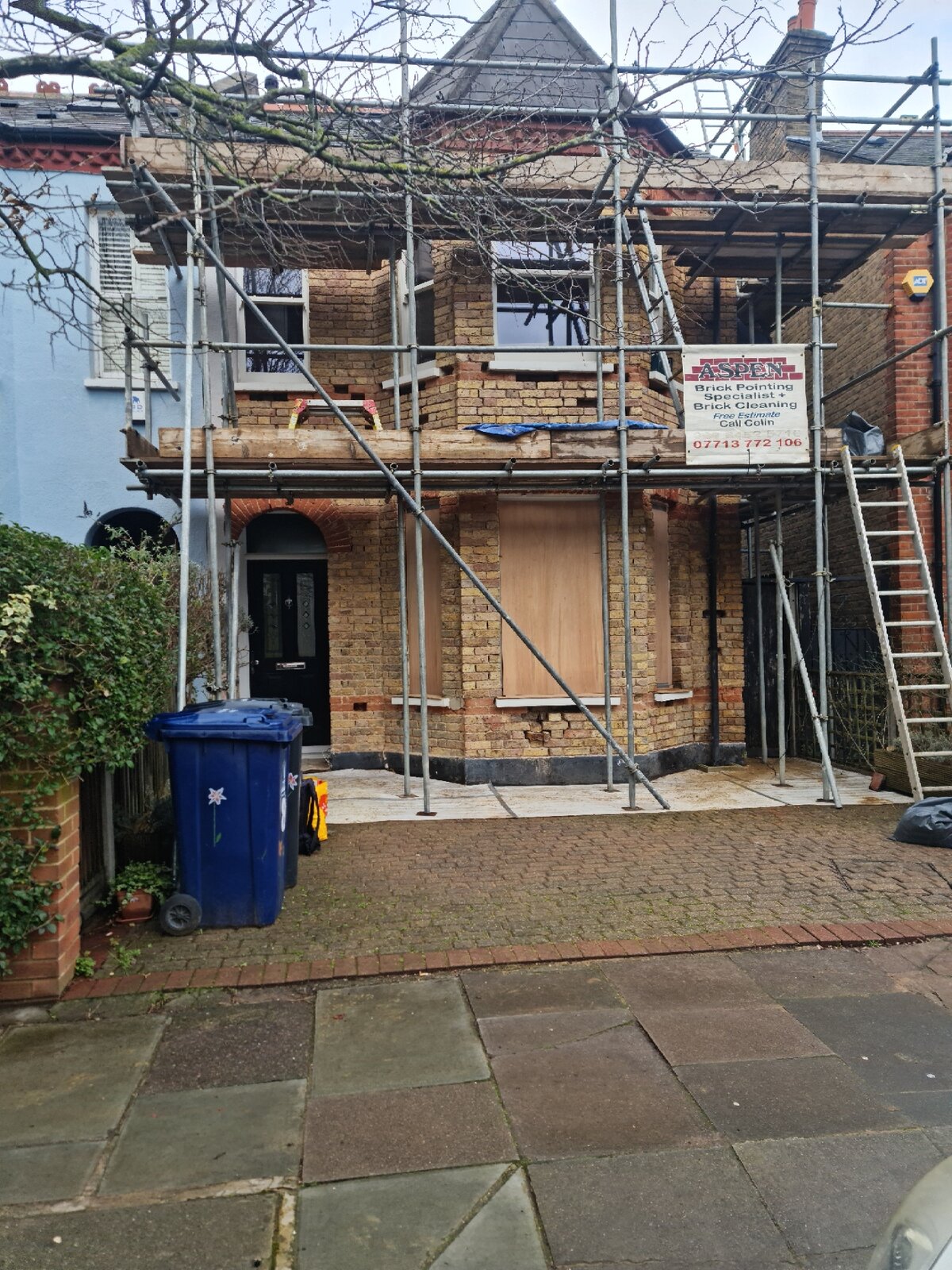

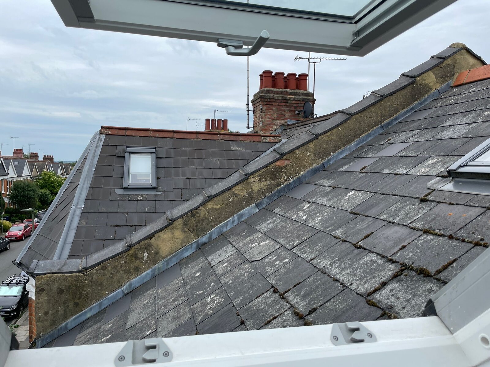

Parapet wall on Edwardian terraced property (London) needs to be urgently partially rebuilt as the mortar has blown and the bricks are loose / unsafe (this was discovered when builders were round to repair the cement render covering this wall).
Builders have quoted £8k +vat (below) for partial rebuild of parapet wall. We are somewhat tied to them as they already put up scaffold and started to hack away the render as they were originally engaged to just repair the render, so they would charge for part of that work, meaning it may not be worth us going with a different company. I'm urgently ringing round to see if I can get some comparison quotes. It is a party wall so am hoping the neighbours will contribute.
Would be hugely helpful if anyone can advise on the 'normal' cost to rebuild a parapet wall. I think it's approx 4-5m in length, and 50cm high.
BEFORE
AFTER ATTEMPTED CEMENT RENDER REPAIR

The price for the "tower" seems pretty high. Here in London, through a mate, I can get a single lift (albeit, first floor) for about £350 (cash). I would imagine that the builder's scaffolders will simply modify the existing scaffolding rather than erecting a new tower next door.

Funny you say that. I sent the quote to a trusted roofer (who's not avail), and they also picked up on the high cost of the scaffold - they couldn't comment on the rest as they'd need to view in person. The scaffold is already on site so just needs adjusting - I'm pushing back on this cost...

Did they use a SDS chisel to remove the render? I don't want to unfairly malign them, but ... the bricks on the other side seem to be sound.
A good friend of mine is a brick pointer. He recently had to remove render from a house in Ealing. He manually hacked it off because he didn't want to damage the integrity of the bricks and crack the internal plastering. It had the same rendering as the property to the left.
I suspect that in your case, he would have used old skool chisels and hammers to remove the parapet render. I am only a lowly decorator, but even I know that using a SDS chisel would dislocate your bricks given that they are at the top of the course.
