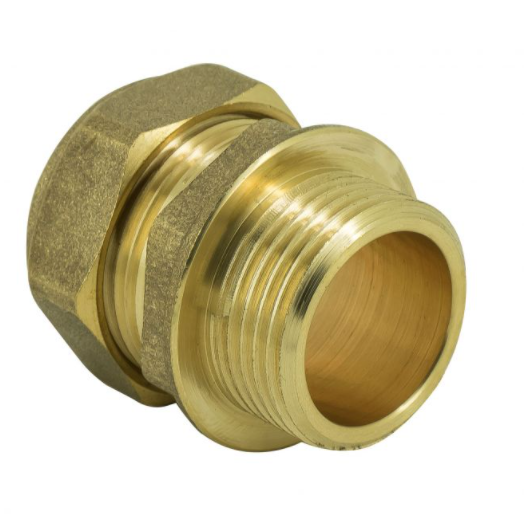

Hi there
My apologies if this question is a bit daft !
I need to blank off the male threaded section of a tap connection which I believe is 1/2" BSP - please see the attached picture.
I have found a 1/2" Female Blanking Cap which I think is a BSP thread which I believe will do the job.
However when I went to purchase the blanking cap I found that there was also a 15mm version ?
I was wondering what the difference was and why both exist ?
Many thanks in advance.
  • THIS IS TO SEAL A 15MM COMPRESSION FITTING. Thread is 1/2 inch BSP thread
  • Important note- These blanking caps for 15mm fittings have a 1/2 inch BSP thread which actually measures 3/4 inch when measured with a measuring tape or caliper due to how BSP fittings are measured. Normally used to seal 15mm compression plumbing fittings which have a 1/2 inch BSP thread . Very flexible product that can be used in cold, hot, compressed gas and air applications and central heating systems.
  • Most plumbing products are measured using BSP thread dimensions which measure 1/4 inches larger than that stated, therefore this 1/2 Inch BSP thread measures approximately 3/4 inches in diameter
Hi Mottie many thanks :) So the 1/2" Female Blanking Cap that I have is the right one for the 1/2" x 15mm Tap Connector that I have. However if I wanted to blank off say a 15mm compression fitting then I would need a 15mm blanking cap ?
I assume a blanking cap for that is a short length of 15mm pipe, capped at one end. If you can buy that, fine, if not, easy to solder a 15mm male blank to a pipe length.
The female blanking cap you have doesn't care about the size of the pipe, only the size/pitch of the male thread.
A compression coupling for a 15mm pipe is almost certain to be ½ inch threads so your ½ inch cap should work but you will need to put a rubber washer or disc inside the cap if it didn't come with one. It doesn't matter whether there's a hole through the centre of the rubber so long as it makes good contact with the lips of the fitting.
If you want to blank off 15mm pipe with no pre-existing fitting, you can get a compression stop end.

Just to clarify, here are the 'official' figures for 1/2"BSP
Major diameter 20.955 mm / 0.825" Threads per inch 14
Wouldn't use a female blanking cap with a rubber seal on a compression fitting, the end will bite into the rubber seal and invariably it will leak. Only use them on 1/2" flat faced ends.
I would always use a compression blank on a compression fitting.
