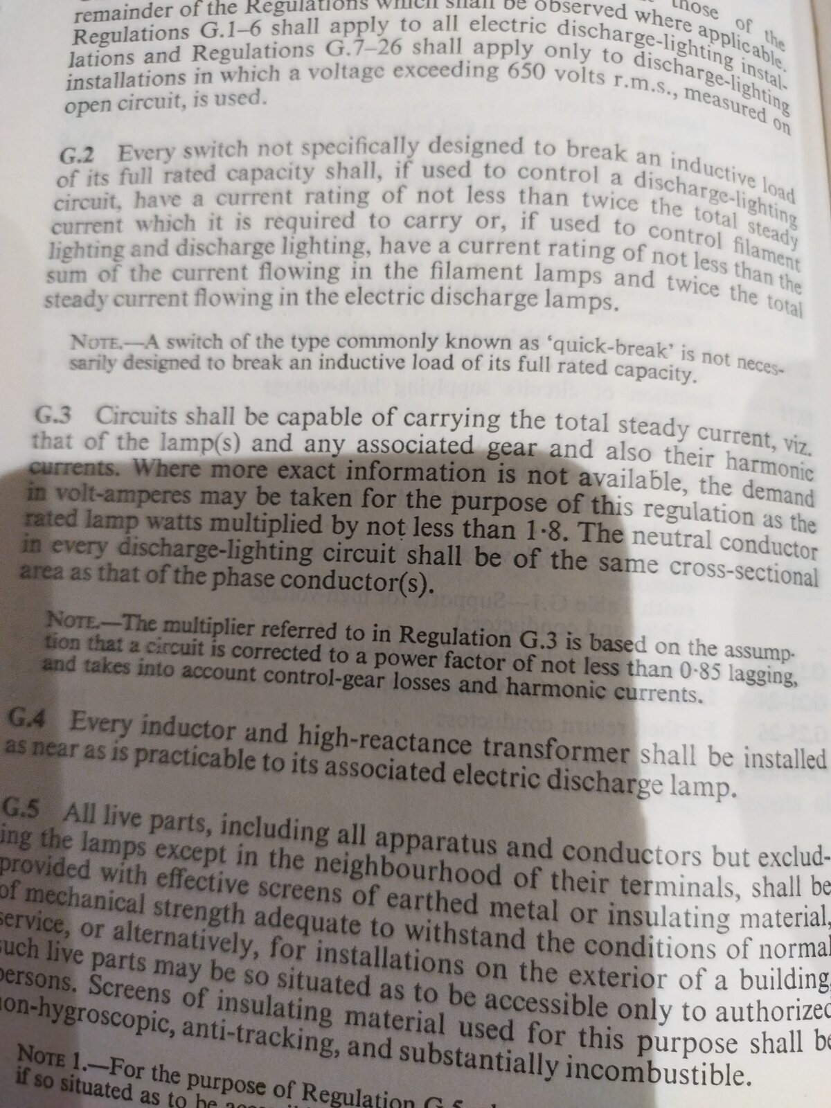

1.8 factor for discharge lighting. Is it in the Regs Book?

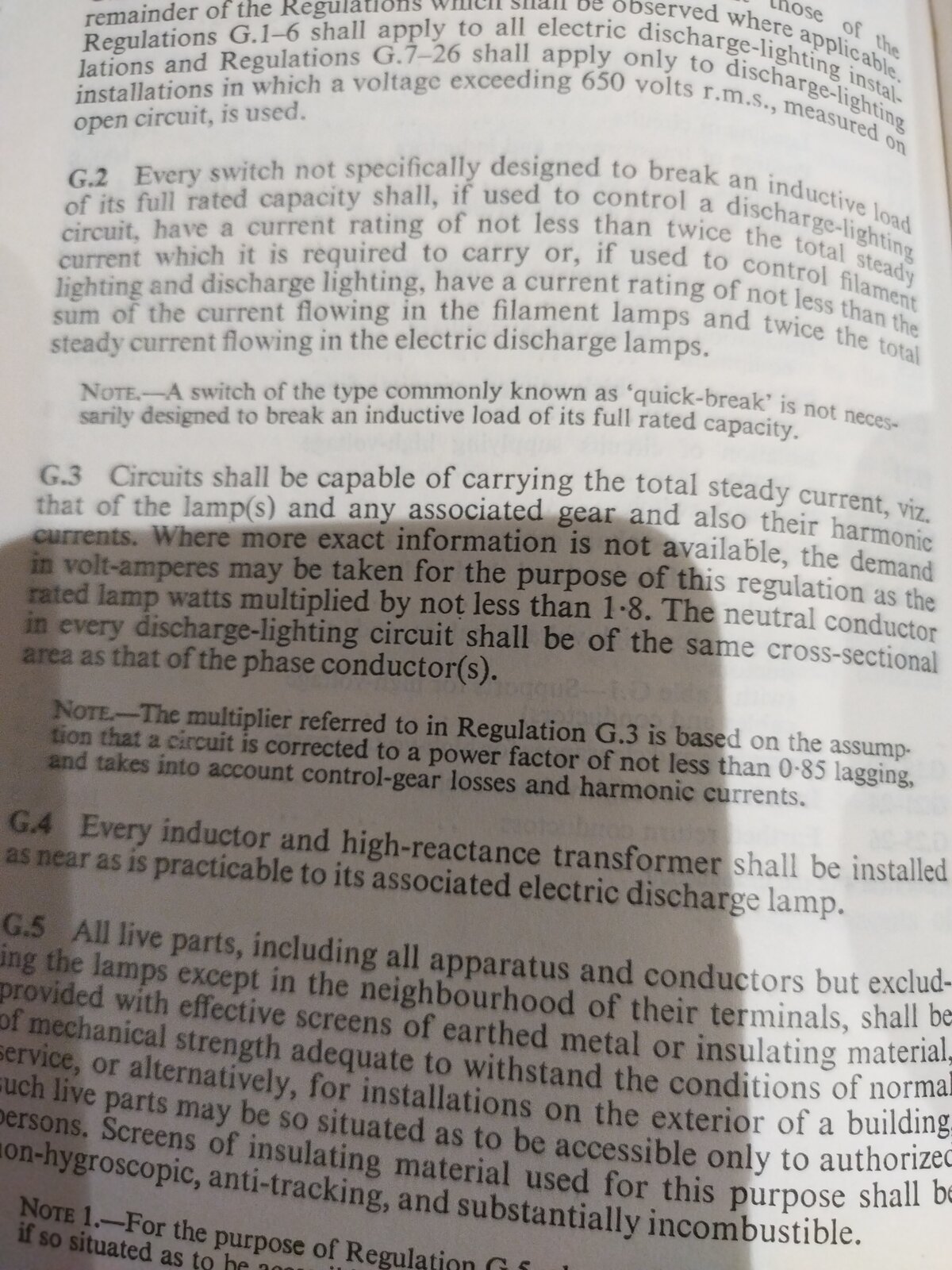

Is there a source for the 1.8 factor used for picking a breaker for discharge lighting circuits?
Is it in BS7671?
This was in the 16th. I'm sure its in the 17 & 18th. Have a look yourself!
I'm being lazy and I'm in the lounge with my broken ankle up....
But I have the 14th Edition next to me....G3.
If no one else posts and I find my 17th (I don't have the 18th), I'll post the reg in that.
Looked in 17th, found nothing.

Searches of digital versions of 17th (DPC of Amd3) and 18th ('original') for "1.8" find no reference to the issue in question.
For reasons that I don't understand (perhaps something is 'going wrong'?), in the case of the 18th there are countless hits on "1.8" when it is part of a regulation number (or, in some cases, a Zs for de-rating factor etc. figure), but there is relatively little of that in my search of (the DPC of) Amd3 of 17th.
I've posted the reg from the 14th.

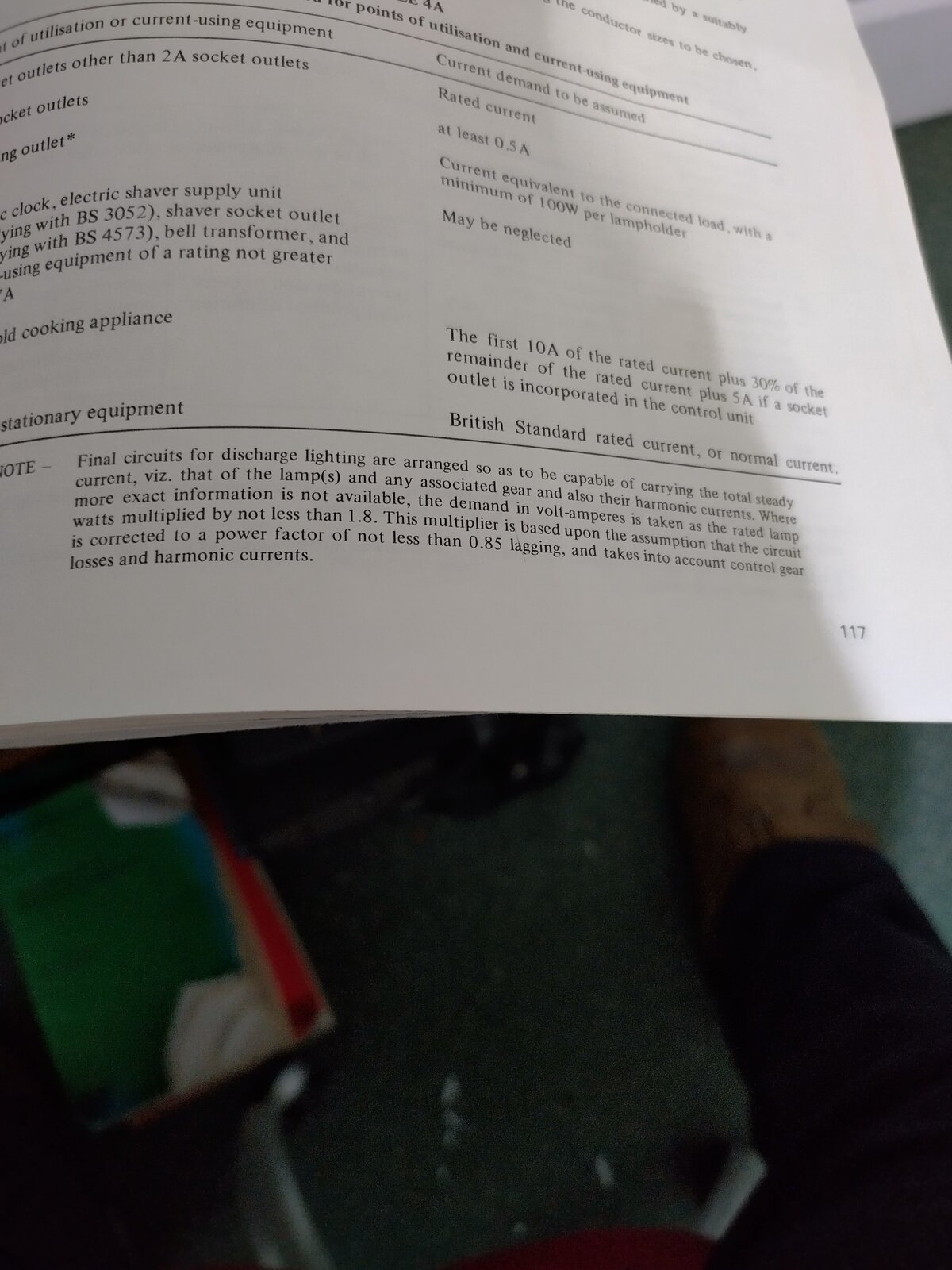

Here it is in the 15th, from 1981.
But it's not a numbered reg, just a note at the bottom of a page.

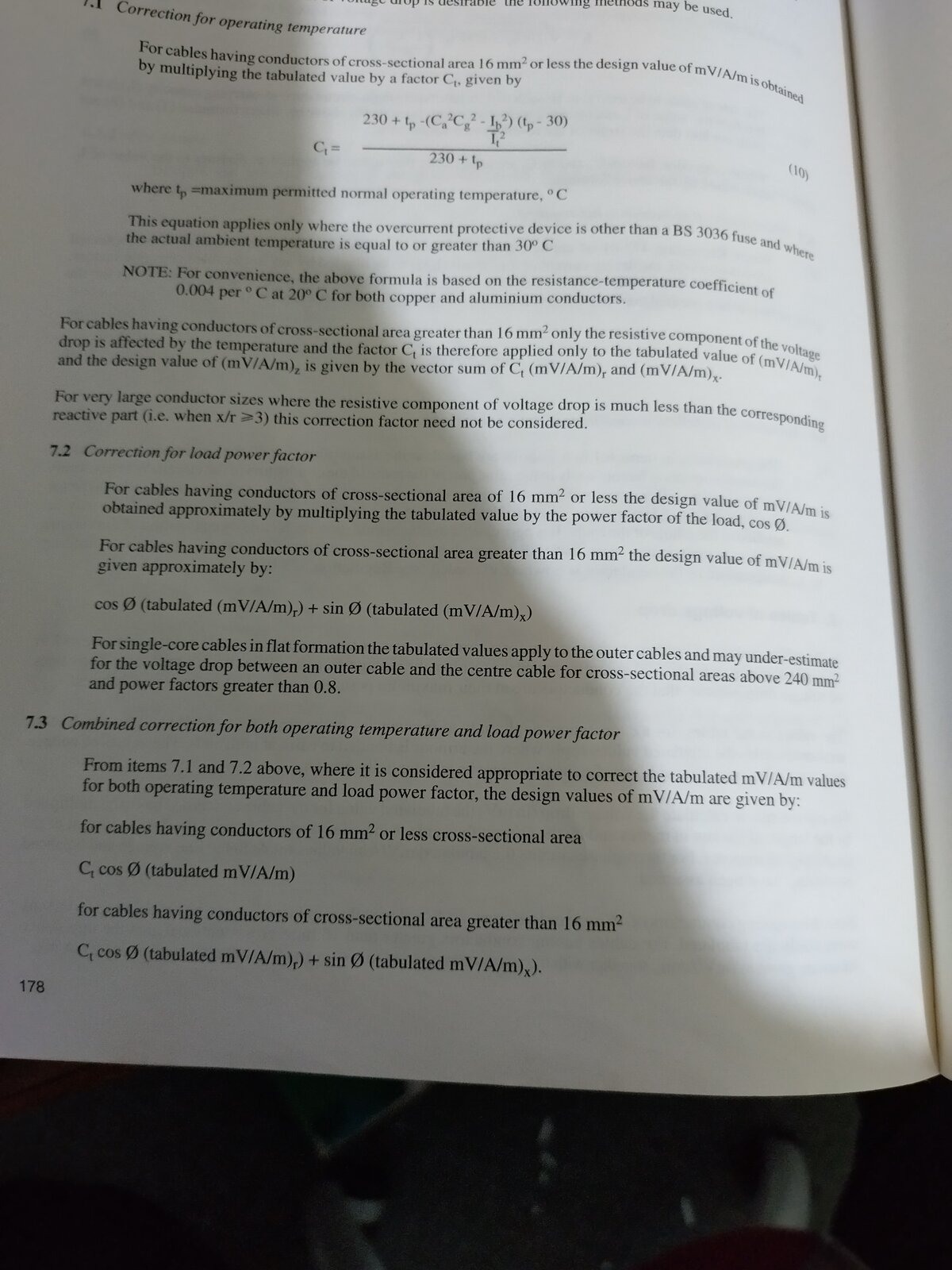

My red 16th, the first to carry the title BS7671, doesn't have that numbering system.
I can't find any mention of discharge lighting and the 1.8 factor in my 16th and I've pretty much flicked through all of it.
The only thing I can find is a general power factor calculation. It's the same in the 16th and the 17th.

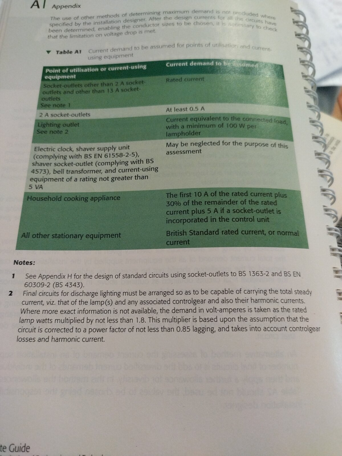

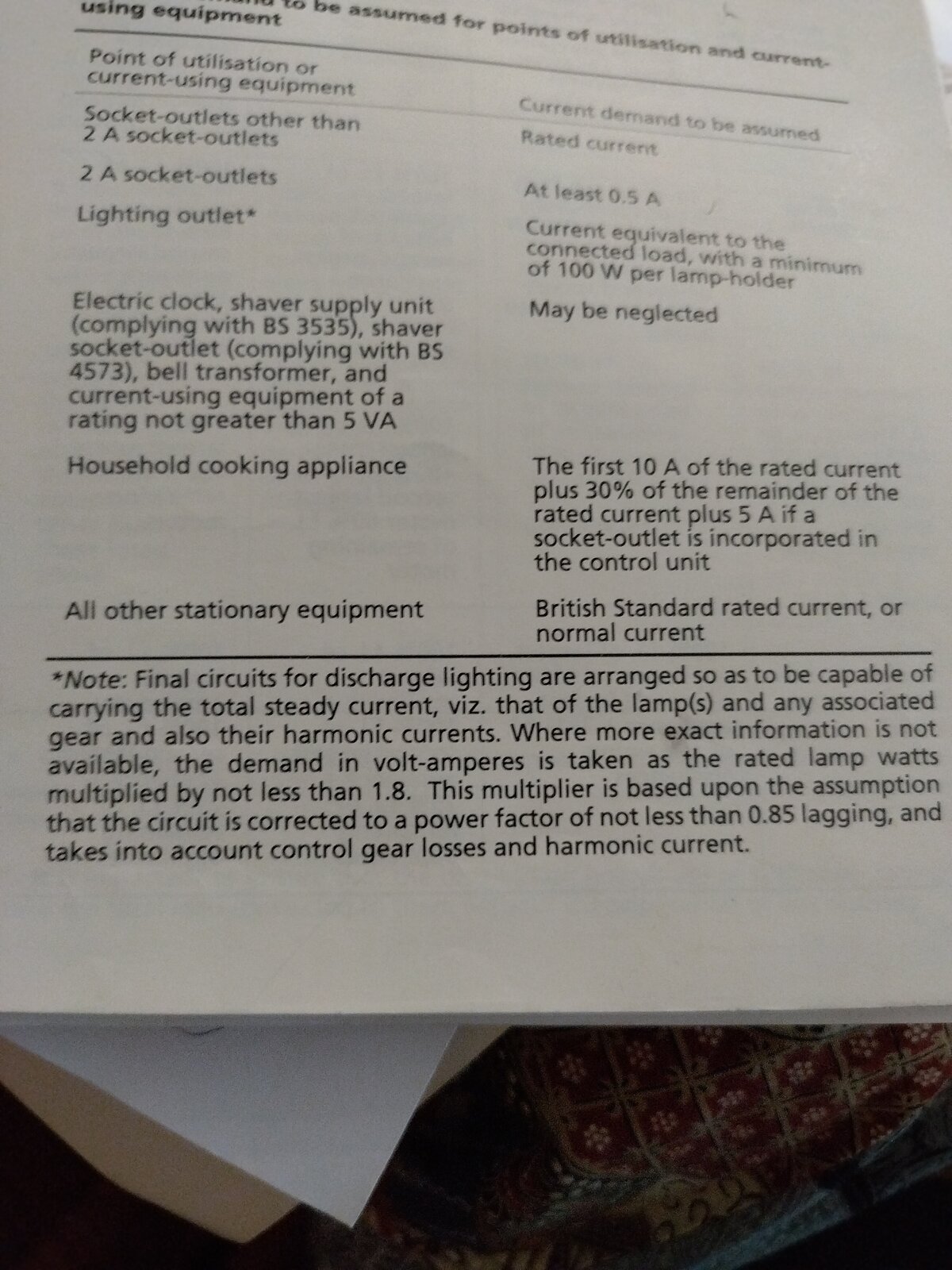

But what I have found is in my OSGs of my red 16th (again the first one to bear BS 7671) and the OSG of the green 17th Edition.
But of course, it's the OSG and not in the regs!
I had a look in the 18th (blue book) it's not in there either, but I might of missed it I hate that book lol :)
