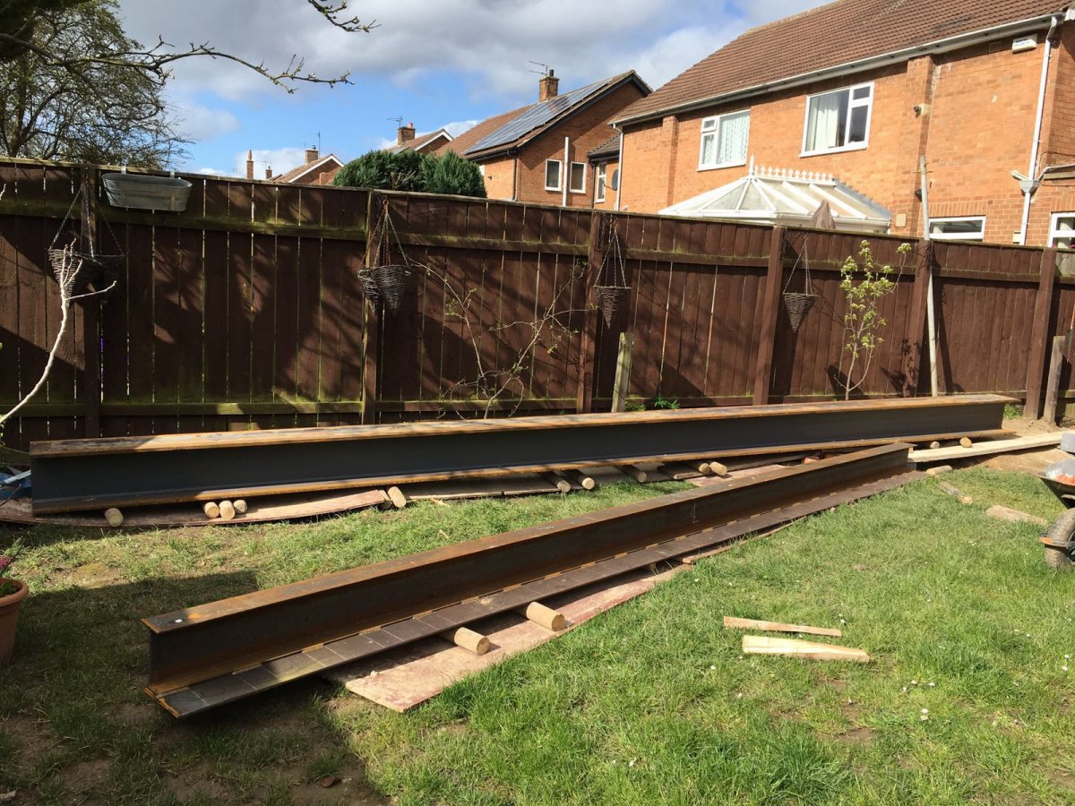

I have had it delivered and have managed to move it down the side of the house using rollers, scaffold boards and a hand winch.

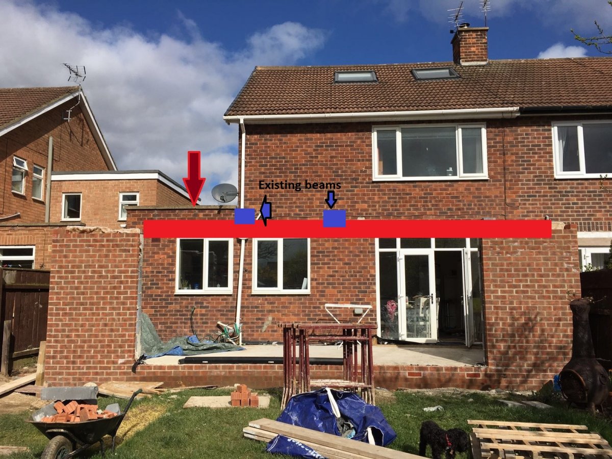

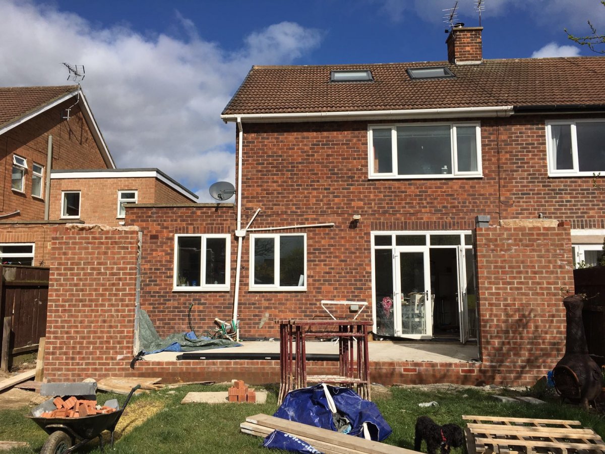

Unfortunately I went back to the engineer (real one, recommended by building inspector) when the size of the beam came back but because the beam will have 2 existing beams going into it (One supporting the gable end of the house) he said the loads were too much for 2 beams so it had to be this big and also it was not possible to cut/splice and then weld bolt together onsite.
I have put on a couple of pics below and tried to show where the beam will go and also where the 2 existing beams are. I am going to remove the wall on the left where the arrow is so will have minimal access above that side. I have also put on a pic of the Beam (next to it is the baby 6m lintel for above bifolds).

Slightly off-topic, but this is another instance of an SE not really giving a proper engineering solution. A chimpanzee could probably pick a beam suitable to carry the load (allowing for stress/deflection etc) but getting it in place?
Perhaps the OP should ask the 'engineer' how he wouldpropose to position this beam, rather than just supplying some figures and then washing his hands of it.
The logical soution here would have been to either (i) detail a bolted splice to have the beam in two sections, or(ii) specify two parallel beams to be bolted or welded together once in position.
He has a valid point regarding the high point loads, which would probably rule out having two separate beams. But it would have been perfectly feasible to design and detail a shop-made bolted splice, say about 1/3 along the beam and away from the incoming beams.
As it is, poor engineering IMO.
Yes .... CDM would require the designer to think about how his design is going to be carried out. I'd go back to him with that, and see if it concentrates his mind a little more.
