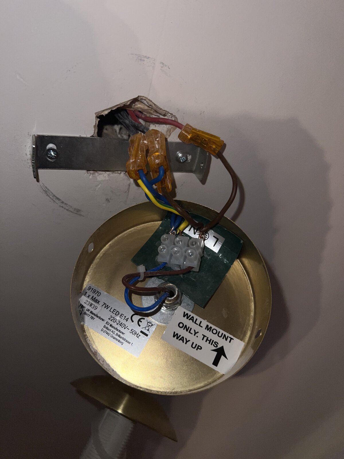

Hello,
I’m a real novice to excuse if the below is confusing.
I’ve recently changed 3 wall lights after the walls were plastered, prior to all 3 lights worked. The wall lights run off a socket fuse.
I’ve installed all 3 however only 2 are working.
The 2 that are working have 2 live wires and 2 neutrals. The one that’s not working only has 1 of each.
I’ve swapped them around so have ruled out that is the bulbs or the light fixing that’s faulty.
I’ve used a voltage pen and confirmed the live wire is okay. I cut the neutral wire as far back as I could and spliced it with new wire.
Any ideas why isn’t not working? Also why do the other two have 2 of each cable and the last one 1?
they are daisy chained together - so the switch/JB goes to the first light - then from the 1st light to 2nd light - hence 2 cables and then last cable to third light

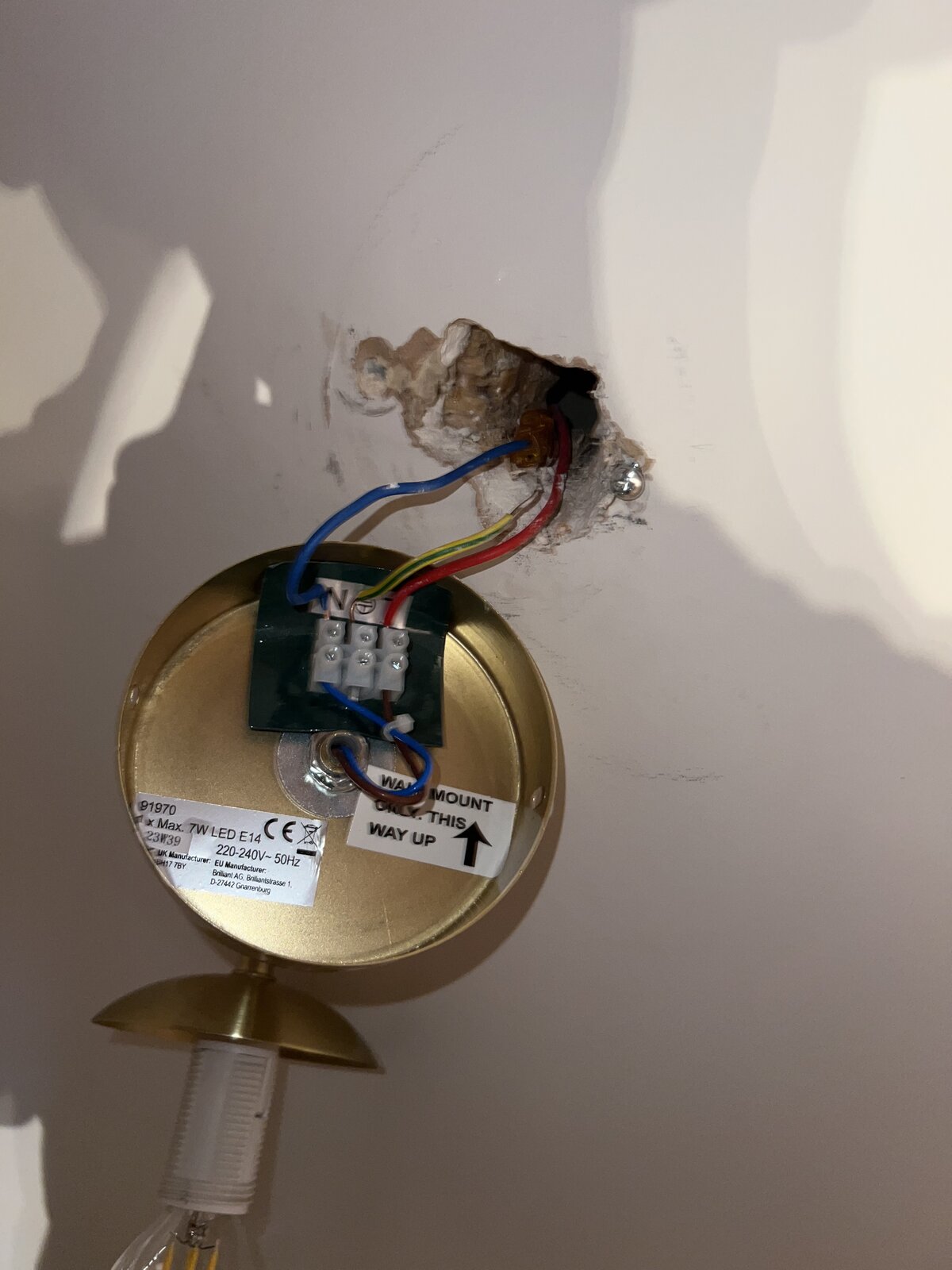

do you have a test meter or just a pen
has the cable broken, or been screwed into the sleeving insulation and not onto the copper
maybe some photos
the Live wire is OK on all 3 lights - with the pen?
Thanks for the quick reply! Right okay that makes sense, it’s the last one on the circuit.
I just have a pen and all live wires are working.
I’ve made sure there’s enough copper to screw in.
I’ve attached some photos. The first one is the 2nd light hence the 2 live wires and neutral. This one works.
The 2nd photo is the last one which isn’t working.

Mate I done it!
Like you said wasn’t screwed in properly.
So the 2nd neutral on fitting 2 obviously wasn’t in properly so didn’t pass it into the 3rd fitting.
That’s my understanding if that’s correct at all?
Great news that its fixed.
The lesson is: Your voltage pen only shows the presence of live.
As you now have discovered, for a circuit to work you need live and a neutral, and those magic wand things wont help you there.
Before your next electrrical saga starts, I suggest you invest in a two probe electrical test device, even a cheap multimeter is fine.
