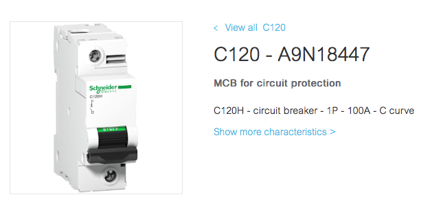

The idea is to ensure the supply does not draw more than 100A and blow the main fuse having to call in the provider, as heavy appliances may be fitted. So, from incomer to 100 mcb and to the rest of the CU (RCD, etc), all inside the CU, not having the 100A mcb outside the CU in a separate casing.
With a 100A fuse and a 100A MCB, there are no guarantees as to which will disconnect first. It depends on the extent of the overload and for how long.
For more uncertainty, old fuses which have been overloaded in the past may fail sooner than expected. Old overloaded MCBs may do likewise. Or not.
Do they exist, 100amp would more likely be a MCCB, these would normally fit in place of a Main switch in a more industrial type board, for a new install you would more likely use a 3 or 4 pole , but you can fit an incomer kit to link out for single phase
SP, 100A MCB
That means having to buy a Schneider CU.
If (like everyone else's) their MCBs are the same height as the main switches, there's probably a 2- or 4-unit wide switch enclosure to fit.

Double pole Schneider. Can this be used as the incomer to save space in he CU?
