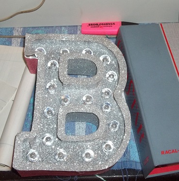

This
has 18 cheap LED elements ( no driver or separate resistor ) connected in parallel to a 3 volt battery supply ( a pair of AAA cells ).
Total current taken from the battery is around 20 mA ( varies with temperature ) so each LED is taking a bit more than 1 mA at 3 volts which is 3 mWatt per LED. This is more than enough for the lights to be seen clearly in a daylit room and to be a bit too bright in a dimly lit room.
The LED element has a resistive layer of semi-conductor to limit the current and this will over time deteriorate and eventually the LED will fail. Short life time.
I intend to replace the LED elements with something like this https://www.rapidonline.com/truopto-5mm-white-leds-64846 with individual resistors per LED . 1K resistor and 9 to 12 volt variable supply ( 9 to 12 mA per LED )

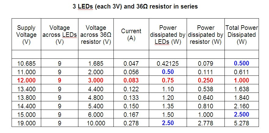

So out of interest would a string of 3 white LED's and resistor likely draw 1W at 12 volt, 0.5W at 11 volt and 2.5W at 14.4 volt? Assuming voltage on the LED's is 9 volt constant then the resistor will be 36 ohm using ohms law 3²/0.25 (9/0.25) as 0.25W on the resistor. So at 11 volt 0.1111 W x 4 = 0.44444 Watt OK reasonably close to 5 W. So now for 14.4 volt so 5.4 volt across resistor 0.81 x 4 = 3.64 W so may be they are working at 13.4 or 13.8 the range of float voltages used? So 0.537777 x 4 = 2.15 Watt or 2.56 Watt at 13.8 volt. Now we are getting close. So it would seem very likely the voltage range of 11 to 13.8 volt is being used to give us the 0.5 to 2.5 watt. Now the voltage on an LED is not completely static and they are not exactly 3 volt each but the calculation is close enough to make it a reasonable assumption. Glad I have a java script program to work out ohms law however.

I get somewhat different figures from you:
As you can see, if you/they are talking about the total power dissipation of the package (LEDs plus resistor), then, if I've done my sums right, that would imply a voltage range of 10.685 to 15.0 volts to achieve a power range of 0.5 to 2.5 W and a total dissipation of 1W at 12V. If, on the other hand, one was talking about the power dissipation of just the LEDs, then the implied voltage range would be 11V to 19V. Over the range 11V-14.4V, the power dissipated in the LEDs (which would be reflected in light output) would vary from 0.5W to 1.35W.
Whatever, my point is that if (as is probably the case) the wide range of quoted powers relates to a range of supply voltages, then they should specify what that range of voltages is (not just specify it as "12V").
This also illustrates the folly/inefficiency of relying on a simple resistor for current control when there is likely to be an appreciable variation in supply voltage (unless the resistor is very large in value, which results in serious inefficiency). After all, one would probably not usually be happy to accept the variation in light output that would result from the power variations discussed above.
Kind Regards, John
