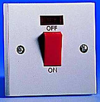

I have a 10mm cooker cable on a separate breaker for my oven.
Which switch do I use so that it can accept the oven wire and also act as the switch. Preferably with a neon indicator too? On some occasions, I have seen a separate switch and a separate connection point. I am looking to converge these unless it is a bad idea.

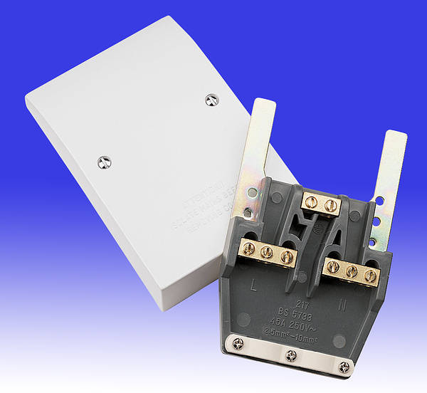

I find the oven and hob situation flawed, with a stand alone cooker the normal supply is 32 amp, and this is normally taken to a cooker isolators upload_2022-4-14_8-51-41.png which is the same switch as used for some shower isolators, fact it says 45 amp on switch does not mean it has a 45 amp supply.
When separate hob and oven is used then a dual cooker connection unit is used upload_2022-4-14_8-55-22.png and with a single appliance a single version can be used.

The normal cooker isolator is a 45 amp double pole switch. Whether 10mm cable will fit I’m not sure.
I would expect a 45amp double pole switch to accept a 10mm2 cable.
Crabtree do 50amp double pole switches, with neon, so this is bound to fit.
Note these switches are usually available as a small one (the size of a single socket) or a large one (the size of a double socket).
I frequently see 10mm2 shower cable used with square 45amp pull switches, so by that token 45amp 'wall' switches must accept 10mm2.
