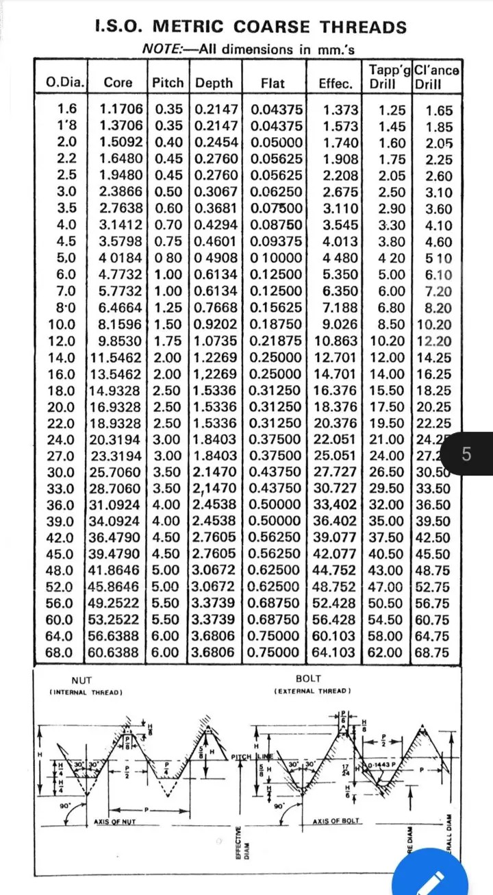

1.5mm
1.25mm would be a fine thread.
@wobs, Ah, that helps. The bits of thread remaining on the old bolt are quite fine.
So I think I'll try to source a 1.25 bolt and see how it fits the internal thread. The internal one is in the end of a small shaft and quite difficult to see the condition of. Do you think I would get away with a 1.5mm pitch and a glob of loctite?
I posted this the other day on another thread...
Got to love Zeus! :)
