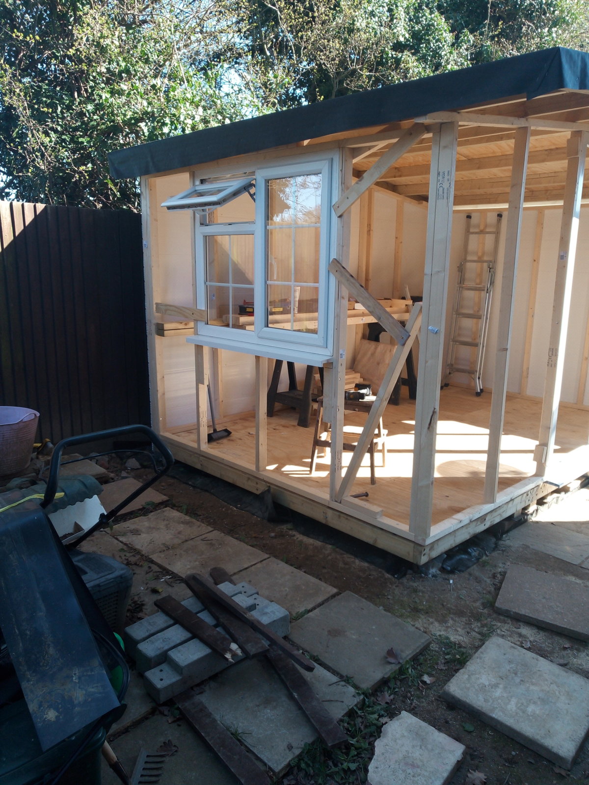

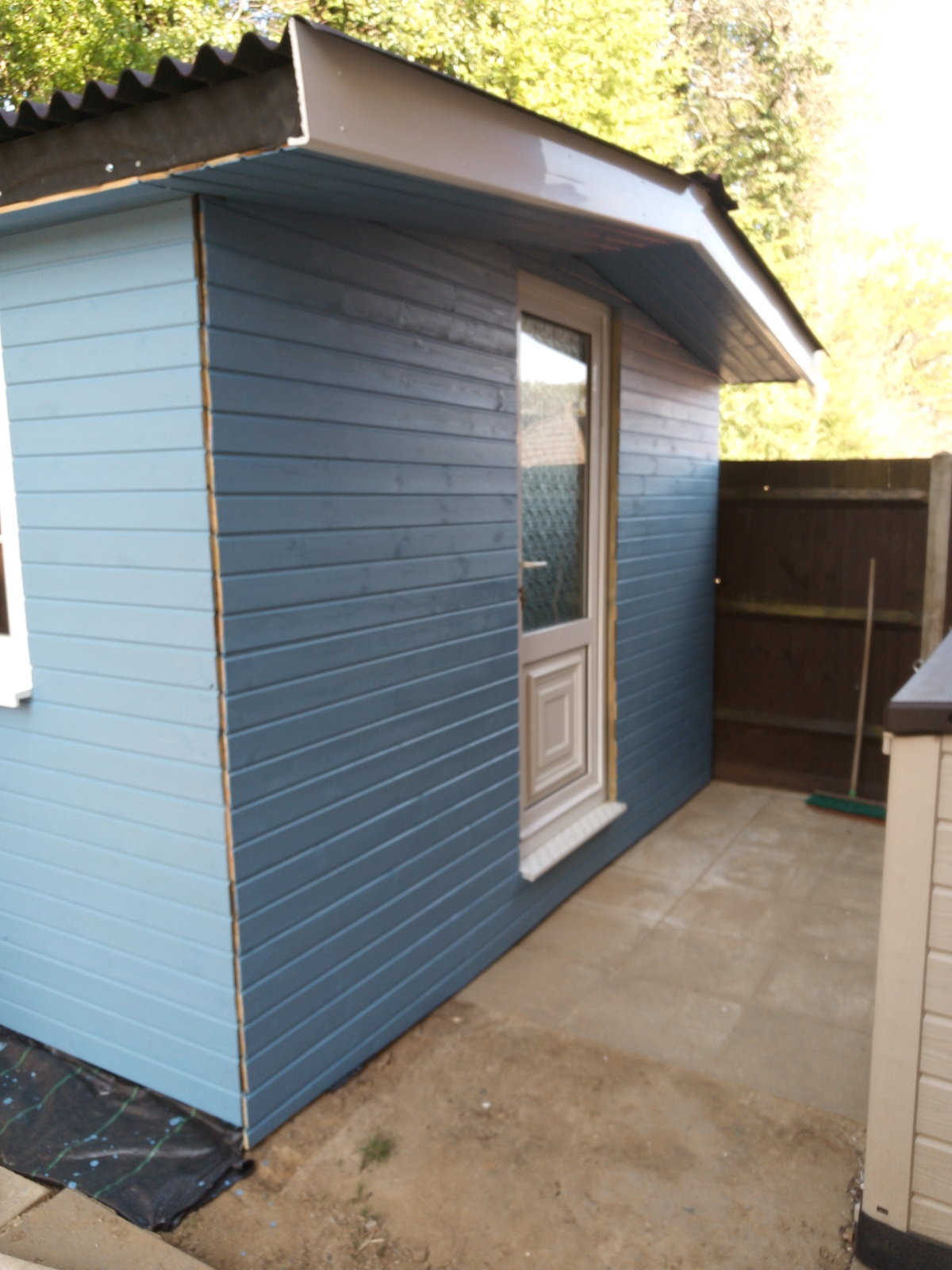

Use 3x2 CLS above ground perfectly strong enough for a shed the size that you are making, I've made a summerhouse and in process of finishing a shed build with the above timber, 4x2 for raised floor frame and roof for my 12x9 shed, pics attached.
