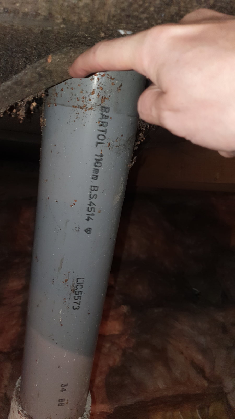

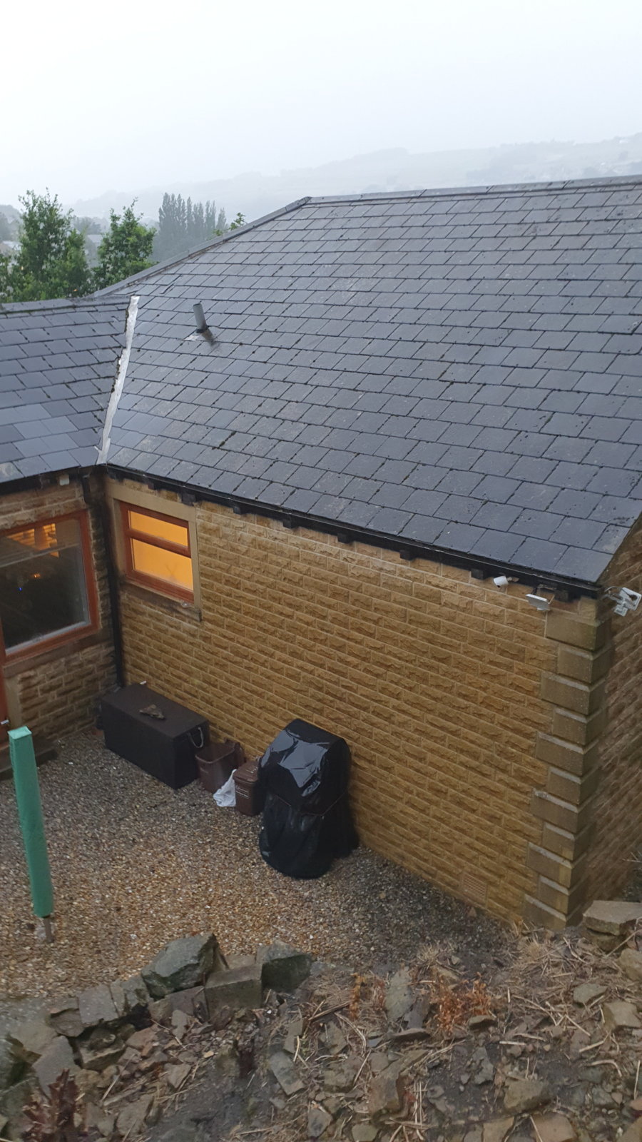

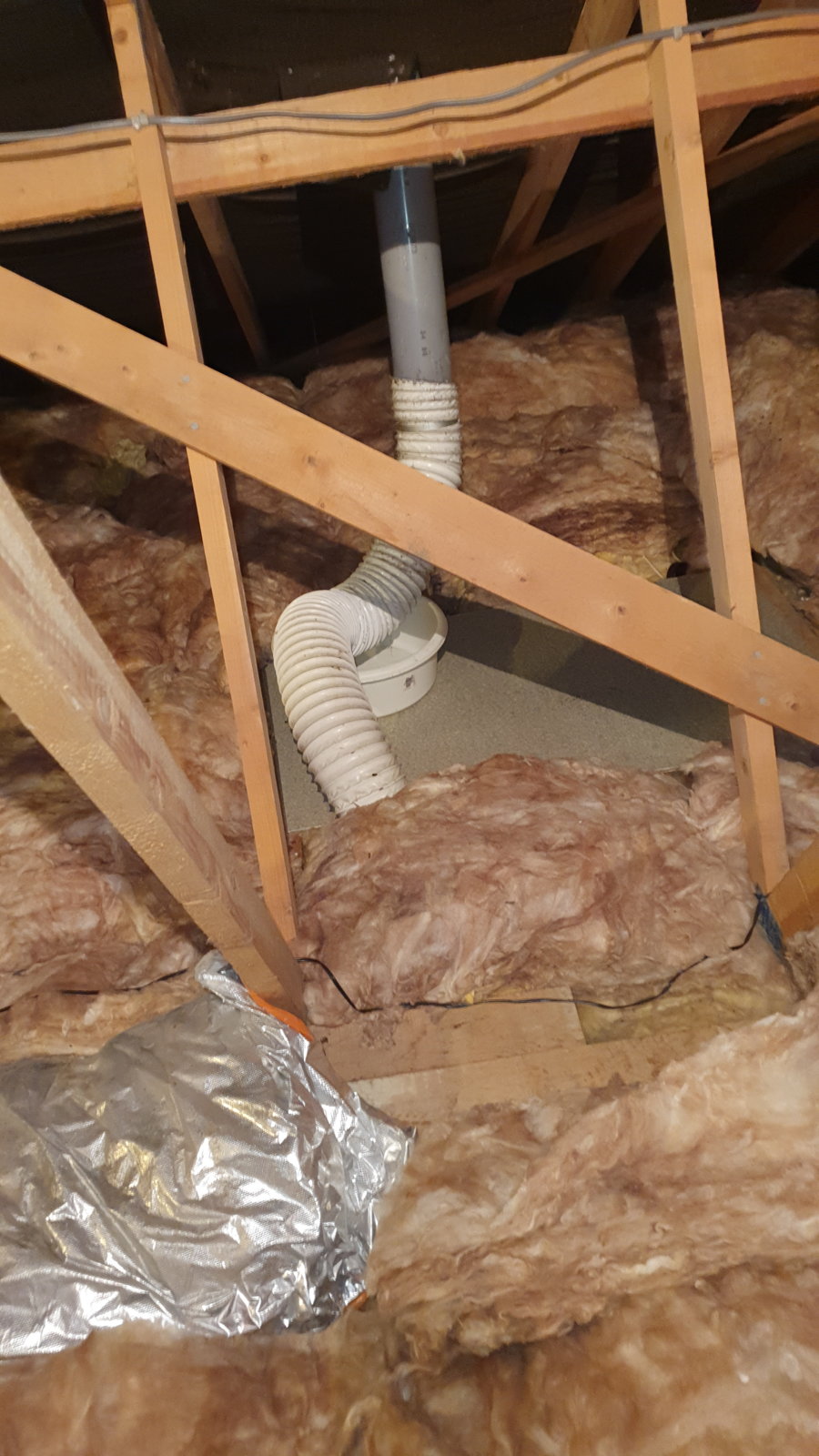

Hi moved into a house that will (money depending) be getting a new roof and kitchen next year.
We are getting a bit of rain water in through the hob extractor (flex pipe cracked). Can't seem to find a rain cover on screw fix or Toolstation... Am I missing something. Worse case is it best just to cap it off (can live without extractor if needs be).
Many thanks,

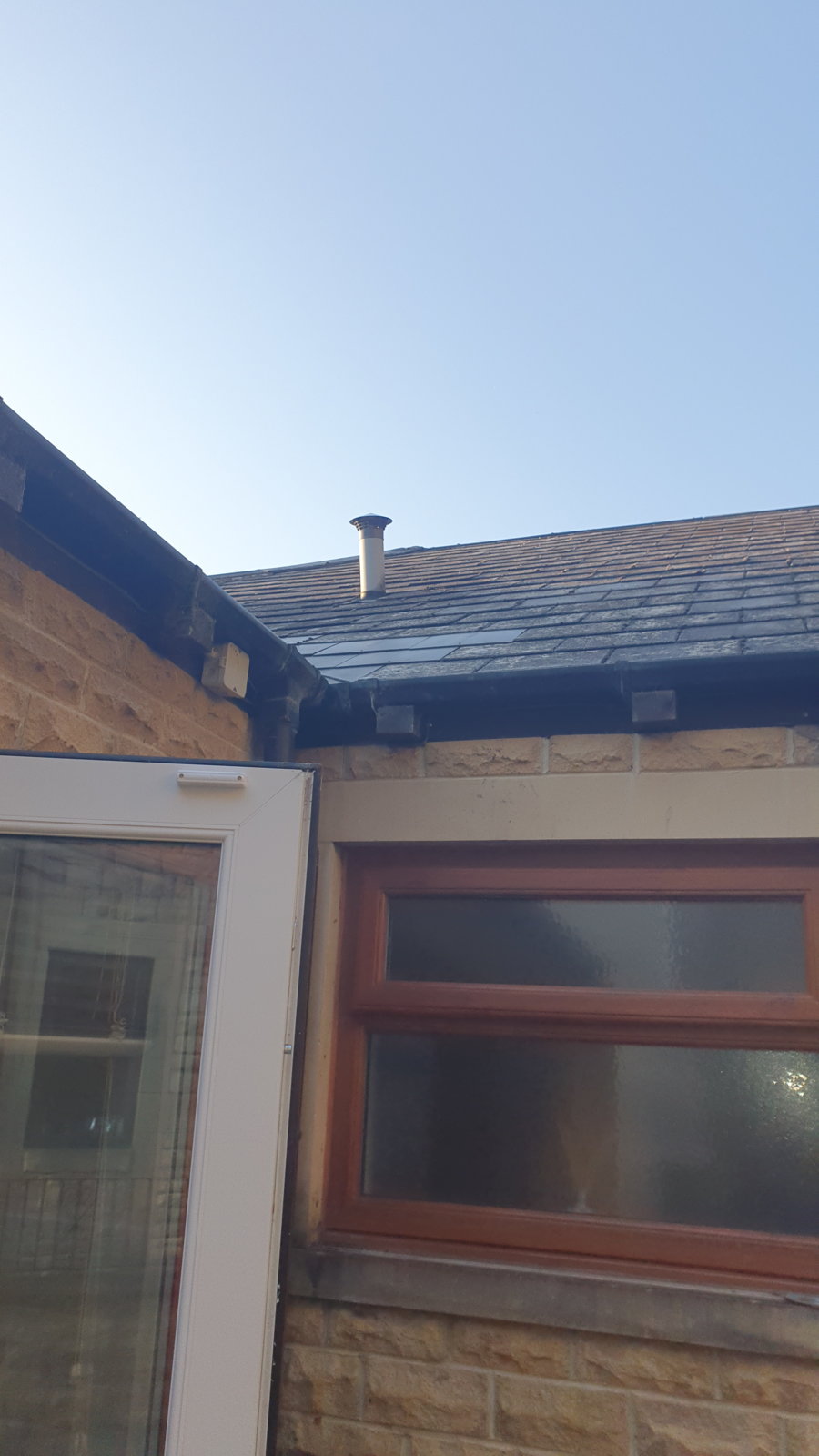

There is the bathroom behind the kitchen and the extractor just above the bathroom window in the picture so why they didn't 'T' into that with back draft valves is beyond me....
Unless you are suggesting this is a bad option....
That's a bad option - bathroom will be a bit of steam etc. Kitchen will be steam and fat. keep separate
Also I find that bathroom ones condense water from higher levels of steam, at the point where pipe goes though roof. And so bathroom pipes often need a condensation trap as pipe passes through loft.
I wasn't suggesting anything about a bathroom extractor , I wasn't aware of one , but you were proposing going out through the wall and I said that would normally be the preferred option if possible etc . p.s. I can't see where an extractor exits above a window, window head looks too near the eaves anyway without a duct going through the lintel :!:
Others have advised against linking bathroom and kitchen extracts anyway ,as well as fitting a condensation trap to bathroom extract duct if going out vertically through the roof.
Is there a gable wall you could run an insulated horizontal duct/pipe to in the roof space ?
Thanks you all for the feedback, there is a very easy path to the gable end of the house, only a few metres, so an easy job and on the side of the house that isn't battered by the wind.... will be a nice easy job and can wait till the loft is boarded now.

Plastic flexing no good for hob extract heat causes perforation and failure .
