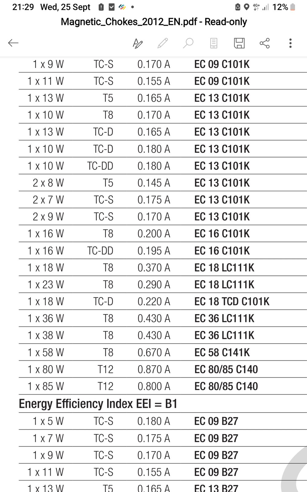

As John says the chokes limit the current, this will be stamped on the choke, when I have time I have a book somewhere with each chokes ratings.
The worst it will likely do is over or under current the filament, if it was severe it would blow and cause tube failure but its likely minimal difference 0.0? Amps
Oddly Tridonic only have the 85w T12 on there website
