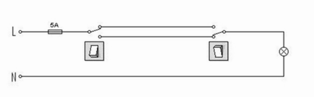

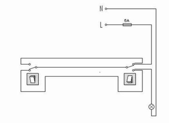

Common does not mean live. It is the switch terminal which connects alternately with L1 and L2 when the switch is operated.
In your method of two way switcing, it is not the Common which is the supply Live.
In another method it is.

There is no neutral connected at the switch.
Look at the schematics. Can you spot where the neutral is connected?

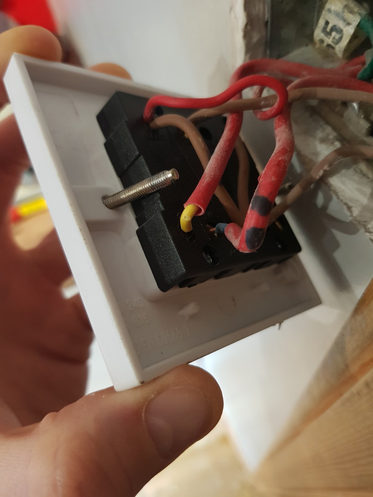

Actually opened up a switch in a different room, and the same wiring and the same voltages is there - even though it's still just 1 light switch in the room
This is the wiring (wires closest). This one is a 3 gang
So in this case, when light is on, Common and L1 I get 12v. C and L2 I get just continuity, and L1 and L2 12v.
When light is off, C and L1 I get continuity. C and L2 i get 240v, and L1 and L2 I get 240v
When testing voltages like that, you should be testing between EARTH (or neutral) and the various cables.
There’s no knowing what you’ll find in other cases.
For instance. If you test between one of the L terminals and the COM, you may be measuring from a live conductor, to the switched live, through the lamp and on to neutral.
Look at the diagrams and try and understand what you are prodding.
