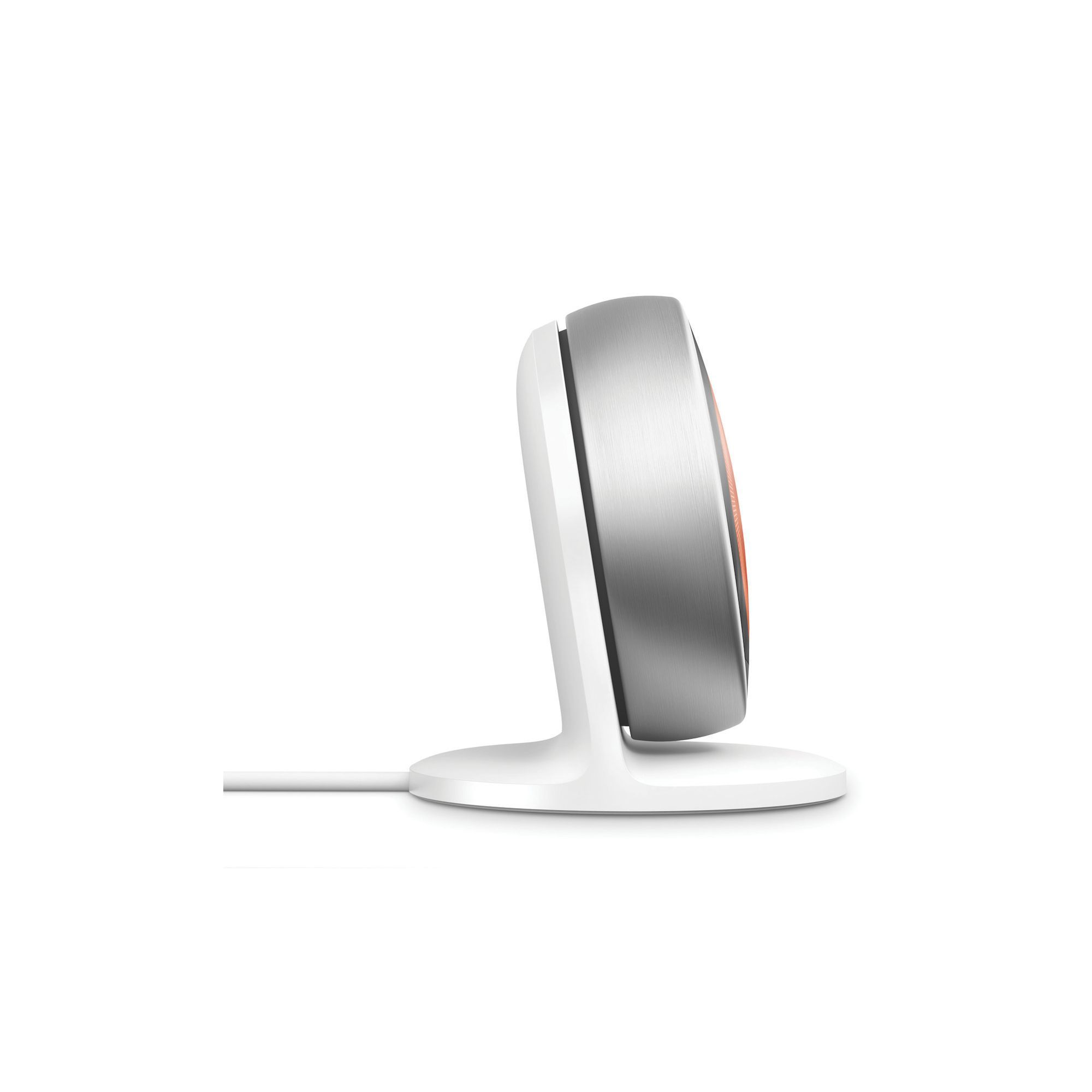

Nest claim the supply from their power supply is 12 VDC however it must be a very smooth 12 VDC as it also carries the info between the heat link and the thermostat, and when the thermostat is using wifi for data the power supply is 5 volt from a USB outlet, as to if the voltage tells the thermostat if sending and receiving hard wired or wifi I don't know, but since it asks for 5 volt why give it 12 volt.
There must be a rectifier in the thermostat as it says it does not matter which way around the wires go, so hopefully it will not damage the unit, however I do see the problem this
0813917021057_02c
does not really fit on a wall, as to if you can get a USB unit for wall mount I don't know?
