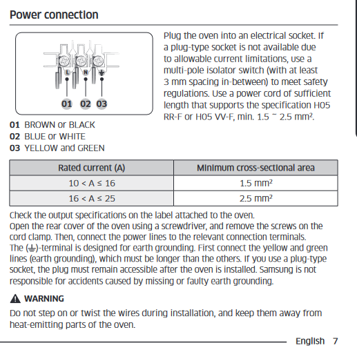

so the oven that im looking at is the Samsung NV7B5750TAK
https://www.samsung.com/uk/cooking-...-steam-5series-dual-cook-flex-nv7b5750tak-u4/
On the first product review someone says "Everything you need in one compact oven - and works on a 13a plug too!"
But i cannot figure out if according to the manufacturers instructions if it is recommended to be hardwired? as it says on the official instruction manual for the oven:
"Plug the oven into an electrical socket"
which im assuming that their recommended instruction is to plug it into a normal 13a plug socket?
The write upon the Samsung website is rather confusing, says works of 13A plug but
Power/Ratings​
  • Power Source230-240 V ~ 50 Hz
  • Output Power3650-3950 W
  • Energy Efficiency ClassA+
  • Oven Temp. Ranges (Single)30~250 (Grill 100~270)
  • Oven Temp. Ranges (Upper, Lower)40~250 °C
  • Oven Temp. Ranges (Twin)40~250 °C
Personally I think that is too much for a 13A socket unless it cannot be used at the maximum quoted but as I said a bit confusing. Perhaps someone else may be able to explain it.

Exactly, normally ive read that double ovens are 16a and hardwired.
But im just worried that if i buy it, then something goes wrong. The fact that I havent followed the manufacturers instructions means that warranty will be void. Even though like you said the manufacturers official instructions have made it very unclear.
Or maybe because it is a new efficient type of oven that it draws less power? totally plucking that out of thin air as i know nothing about electrics lol but just thought that might be a plausible reason?
In the UK, if it can be plugged in to a normal socket, then it should come with a moulded plug attached - a pretty good indicator.
A first look suggests the 3900W is the combination of the convection, upper and lower grills altogether - a combination that may not be possible (or desirable!) all at the same time!
Some further investigation may be necessary...

Indeed, not to mention 'diversity', even if everything can be 'switched on' simultaneously.
There are after all, some induction (and maybe other) hobs with 'intelligent controllers' that can be used with a 13A plug.

In reality, of course, there is virtually no difference. It takes about 23A continuously for 1 hour to trip a B16 MCB, and about 22A continuously for a 13A BS1362 fuse to ever blow.
