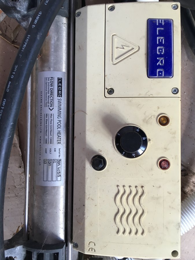

Ok so i moved house and brought the 14kw heater wire with me so i need i to wire it in the fuse box in the new house.
So i have the 14kw heater and all the SWA armoured core 10mm 3 core wire and fixed the commando box to the wall and tapped the wire in along the wall using clips/cleats to the fuse box, now just wondering what AMP trip switch to buy for the fuse box??

Out of interest what is make/model of the pool heater?
Sorry my mistake its a 12kw and this was just wired in to the fuse box in the old house?
Quite apart from my other, more general and more important, comments, that doesn't alter anything I said. It still requires over 50A, so that, in practice, a 63A MCB (or higher-rated MCB/fuse) would be needed.

Out of interest what would happen if i used 50A MCB but needed 63A mcb would it just restrict the power to the heater??
No, it doesn't work that way round.
You would overheat the MCB.
You actually need a 52.2A MCB but they don't make one.
It would not restrict the power to the heater, but would probably not be sufficiently under-rated to actually 'trip'. However, it could get very hot, and theoretically might 'burst into flames' and/or adversely affect nearby MCBs.
