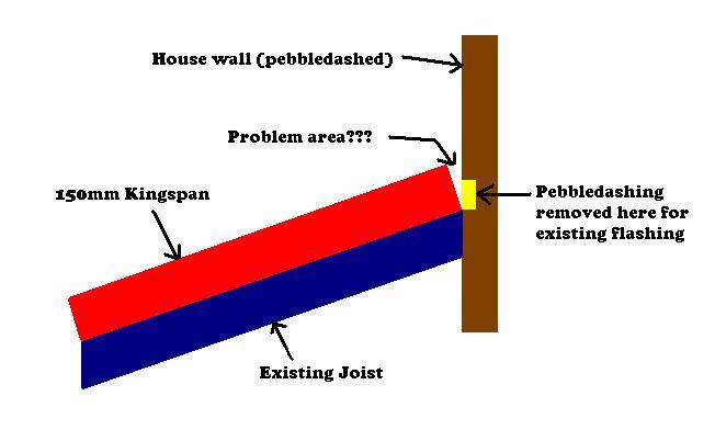

I am preparing to convert the garage that is attached to my house into a private recording studio.
In brief, this will entail building a decoupled room inside the existing shell, but without going into those details, the big problem I have is that the existing garage roof is simply corrugated plastic sheets fitted above the joists --- and these are "flashed" into the pebbledashed wall where the garage meets the house.
It would take some time for me to go through all of the details relating to the build requirements for a studio environment, but once completed, I would essentially have a double layer of 5/8" Gypsum as a ceiling, about 4" of rockwool insulation above that, then at least a double layer of 18mm OSB.
There may be a small air gap between the rockwool and the underside of the OSB, but I cannot ventilate this space as I need to seal every possible gap and make it as airtight as possible (in theory).
I therefore need to build a warm roof and having researched as much as possible, I have been advised to fit a minimum of 150mm of Kingspan above the OSB decking to avoid condensation.
If I lay 150mm of Kingspan as well as 2 x 18mm OSB on top of the joists, then I will be faced with two problems.
Firstly, there will be a natural angle caused by the slight pitch of the roof where the Kingspan meets the house (see diagram) and the uppermost surface that would need to be waterproofed would end up above the strip on the house wall that is already stripped and chased of the pebbledashing (this strip is where the current flashing for the plastic roof is attached to the wall).
I am loathe to have to chase a new strip further up the wall, so am wondering if anyone has any ideas for these two issues?

Indeed- but it is a DIY forum :LOL: . Consider having a strip of pebbledash rendered over , proud. then use flashband over that :idea:
Hi. The problem area as you describe it only requires the king span to be cut at the angle to which it abuts. With a 9" grinder and diamond wheel cutting a chase to secure lead flashing will take approx 3 minuets a meter. When veiwed against that which you are proposing is a small part of the total and worth the effort. Good Luck

1. I know I should be reading up on this, but if I did chase a new channel, is it necessary to strip the pebbledashing to create a flat, bare section of wall beneath the channel, or is it possible to cut a channel that is just wide enough for the lead to be "hammered" in and then running the leadwork down over the pebbledashing and onto the roof?
2. If it IS possible to avoid stripping/baring the wall beneath the channel, then what is the minimum width and depth that needs to be chased in order to take the lead?
As an alternative option - although it involves a lot more niggly work for me, is to fit the 2 x layers of 18mm OSB cut to size to fit between the existing joists so that the TOPSIDE of this OSB deck (once fitted) is 75mm below the top edge of the joists --- then cut 75mm sheets of Kingspan and fit them from the top in between the joists, but now resting on the "countersunk" OSB deck - so that this first layer of Kingspan ends up flush with the top of the existing joists.
I could then lay a second layer of 75mm Kingspan over the top and this would bring the roof up to a level where I could probably still use the existing section of the wall that is stripped and chased for the existing flashing if you know what I mean.

Hi. If you were to cut a chase and fit lead flashing? in the event of removing kingspan at a later date, you can simply leave the flashing in place an dress to existing roof.
Have you considered screwing sat 3"x2" timber on existing rafters? So as the insulation can be accommodated within the existing building.

If I were you I would leave the existing roof covering alone and concentrate on putting the insulation on the inside - if you use a PIR insulation you can halve the thickness of insulation required.
First step, place PIR insulation between rafters - leaving 25-50mm gap between existing roof covering and top of insulation assume you have 100 x 50 rafters therefore around 50mm insulation between rafters and then go over the face of the rafters with another minimum 50mm thickness of PIR insulation. PIR has a high vapour resistance and you should not get problems with condensation.

No your making it too complicated! Place insulation between the rafters so that it finishes flush with the underside (narrow face) of the rafter and then place another layer over the whole of the underside of the roof structure just as if you were putting a plasterboard ceiling up, using screw to fix the insulation to the underside of the rafters, only in this instance you won't need the plasterboard ceiling as you are putting in a decoupled shell, which I assume includes a ceiling of some description. As the insulation alone will not provide the sound insulation that you will be looking for!
Putting it simply - put your red section on the underside rather than on the top of the rafters!
