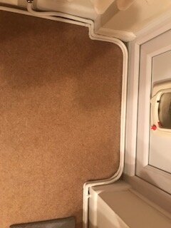

I would like to sink a short section 1 (metre )of 15mm Ch copper pipe in the concrete floor where it crosses a doorway. Does the pipe need "lagging" and how deep should it be? I intend to box in the remaining pipe.
Yes lag it, if you're sinking it in wet concrete then protect it (duct or Denso tape). Depth- deep enough so some idiot won't put a screw through it
It’s always messy:cautious:
Grind (Diamond disc) a couple of lines to your chosen width, then chisel out. If you have an sds+ drill with chisel function, it’s a simple job.
might be easier to cut straight across, rather than follow the wall contour.
Yeah as above. Before you start slicing the concrete up, check where your gas, water, electricity enter the house- if it's a terrace & that's the hallway then good odds they're in that area somewhere, should be over a foot down but might not be...
Cool. Well worth getting a load of polythene and sheeting over doors etc. If you don't own an angle grinder, look at hiring a wall chaser- the blades are enclosed so a good vac on the outlet will clear a lot of the dust for you
Maybe hire a chaser.
Re the dust, open door, blow dust outside with leaf blower!?:D
