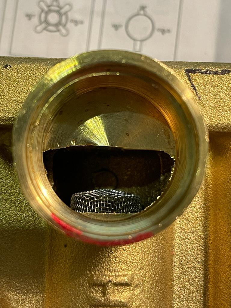

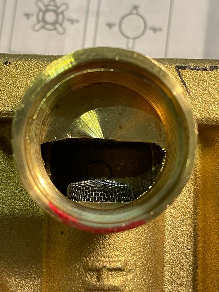

The shower valve seems to take a 1 inch type feed in for hot and cold.
I seem to struggle to find connections 15mm to 1" which in itself might be telling me something!
See image:
I'm struggling to figure out the connection size for the exit connections (image below) to the shower head and shower hose. Looks larger than 3/4inch but maybe I am not looking at this correctly. can someone help please?

The inlets are 3/4 inch BSP thread ,and the outlets 1/2 inch BSP thread.
15 mm supply's from the pump are fine.
1. In theory your shower pump is a little underpowered for the new shower. In practice it will probably be fine.
2. The inlet thread is most likely 3/4" BSP. The outside diameter of a 3/4 BSP male thread is 1/04"
3. You need a male 3/4" to 15mm compression male "iron" (they are made of brass). Screwfix 82086
4. If the face of the inlet hole is flat, then a fibre washer between the 3/4" BSP of the iron and the face may provide an adequate seal.
5. If it were me I'd be using Flomasta pipe seal (Screwfix 4373J) on the threads to guarantee a seal.

Looking at the face on the inside of the inlet I would say no washer?
