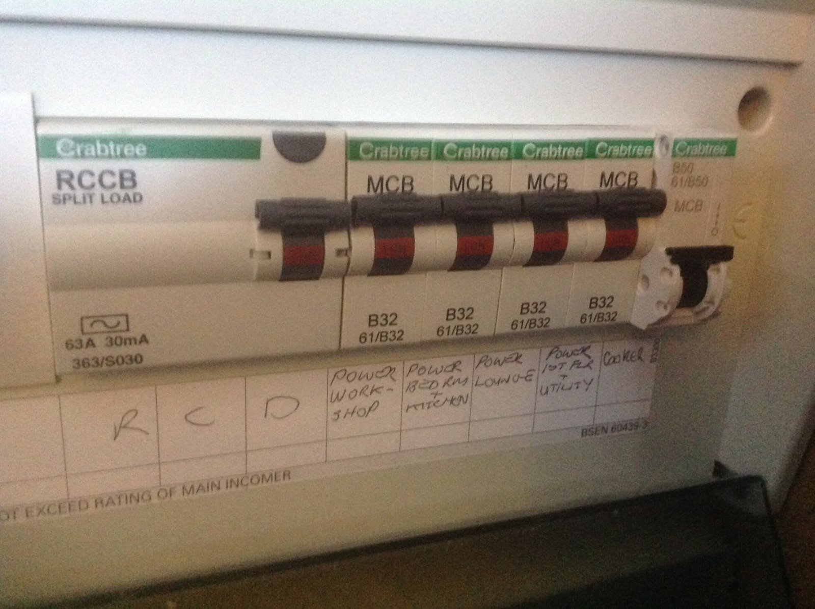

An RCD would be a BGI.
I didn't notice that. Although, that little unit is downstream of the main consumer unit - which does have an RCD. Does that make it OK?
It's the one labelled 'Power Workshop'.
OK.
Given the apparent skill/knowledge that went into using conduit, it didn't occur too me that whoever did that would have taken the supply off an MCB in the house CU...
There's 25m of conduit all very neatly routed through 3 'rooms'. The quality of the wiring and termination looks professional to me. They did a ring for the double sockets and a radial for the lights and one for the single sockets.
There is evidence of alteration with the supply though so it may have been bodged by someone else at a later date.
