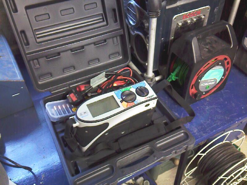

I treated myself to the Megger 1502/02, I paid £300 from fleabay....Bargain :D :D it was 3 months old with all the certs and leads (all bar two were still sealed in their packets including the illuminated switch probe).
The only real niggle is the backlight times out a bit too quickly, some days I wish I'd gone for the 1552 with the auto RCD test facility, but hey the walk does me good :D

Megger (1552/53) seems to be the favourite.
Fluke has a love/hate kinda response.
