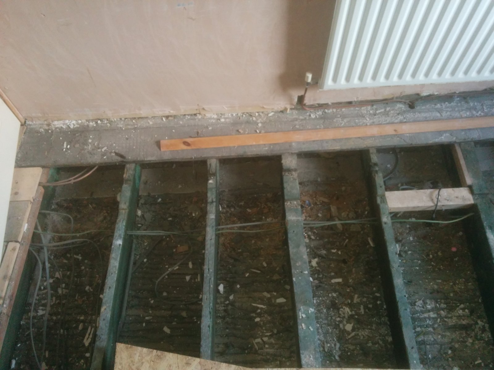

My partner has just brought a 1890's built cottage and I am fairly concerned a supporting wall has been removed without any additional support. The joists are about 1" wide by 6" deep and seem to be spanning around 5m and are pretty bouncy and sagged. (the lounge ceiling is (was) artex so it hasn't happened in the past 40 years but I suspect it has happened!)
I need to lift some of the floor in the adjacent bedroom to check they do run the full distance
was it usual for them to construct with such small beams and long spans way back? (they are about every 30cm)
Not really sure what to do!?
Lounge ceiling is very low so a beam in under isn't really an option, hiding it in the void is way more disruption then I would like to cause. (and the ceiling has just been plastered!)
sistering the joists with either steel or timber?
Leave it as it is?
There was a fairly detailed survey done but nothing picked up...

How low is low (ceiling height)? And how is the headroom in the rooms above? You could try sistering 6 x 2s to the existing (which will reduce the bounce but maybe not the sag), or rip some 25mm ply into 6" strips and sister with that (common in the US, again it'll stiffen the joists but probably not do much about the sag). Current span tables say 50 x 220 C24 for that span......and unless the sag is blatant (like 50mm + drop in the middle with visible cracks) you can forget chasing the surveyor

I do think a wall has been removed at some point in history. I've no experience with old houses but two windows in the livliv room and small plasterboarded section of ceiling splitting up the lath and plaster all point towards it.

Thin joist are actually 1.5" with a couple of 2.5"
There has definitely been a wall removed at some point. Just visible in the picture the lath and plaster finishes and there is 150mm of plasterboard the lath and plaster starts again..
Old wall would have been ,1.8m into the 5m span..

yeah, that photo is a different story to your first post.
the wall looks like a stud partition but it still carrys weight.
if it comes to it you can slide in rippings of 3/4" ply an sister them with lots of screws.
the ply doesnt have to be the full length of the span or the full depth of the section - it can be short of the bearin walls.
any sisterin has to take account of insitu cables an pipe
Would ply be better than c16 timber. Is that a suitable alternative to splitting the span with a beam?.
I did consider 3mm steel plate. Not sure how that would compare to ply.

Thanks Keith, all work was finished 8 months ago. There is now a ub in there and it's nice and solid!
