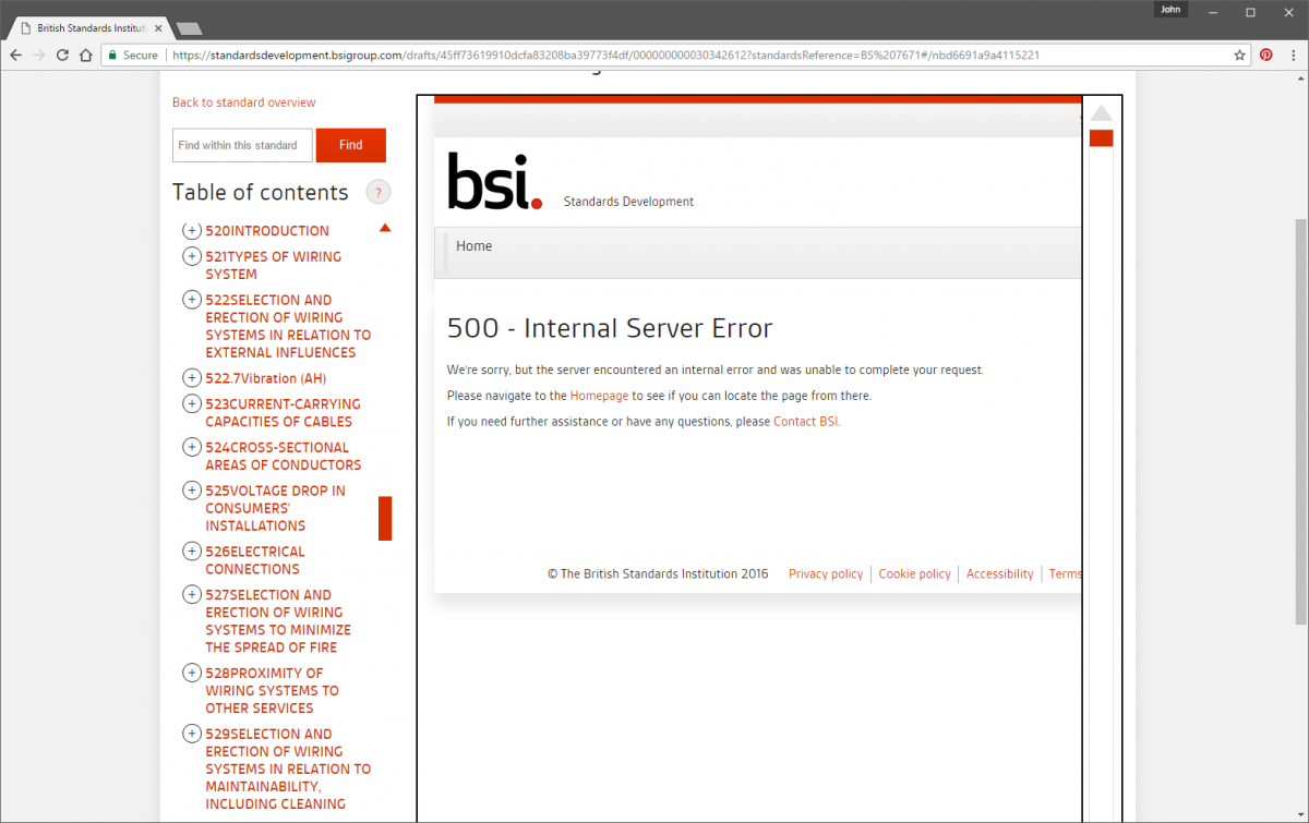

18th edition draft now available for comment
5 days after it claimed to be initially available and wasn't, and now this:
What a total shambles.
If this is typical of the 18th edition, we are all doomed.
