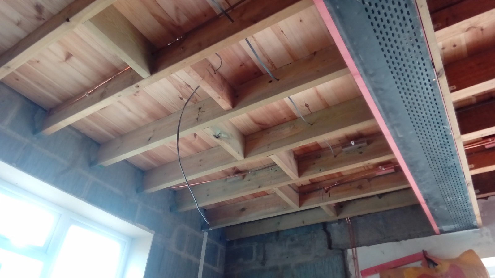

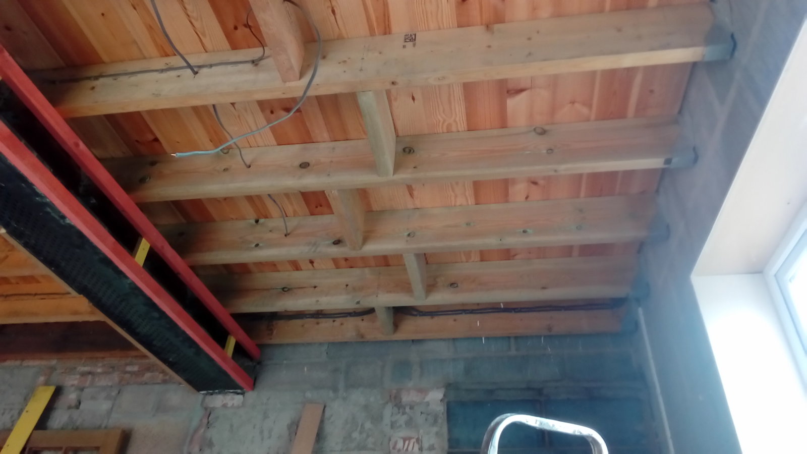

Yes i don't know off hand but just read the on site guide for the plasterboard manufacturer, it has all the info. Should be available via Google.
I think you will be fine though as long as you are accurate enough with the boards.
How do you think ceilings/walls are normally boarded on 47mm width joists? You’ve posted this question before, and already had valid answers. What is it that you’re worried about, and causes you to ignore the various helpful answers you’ve already received?
With everything open it was easier putting sisters on than the faff of carefully splitting a 47mm landing, which, once you disregard the radiused corners, is actually only 40mm anyway. So, I'll use tapered edge PB and drop the sq edges on the sisters, stacks of landing there now.
IMHO, sometimes, what is easier for the tradesman may not necessarily be better in the long.
