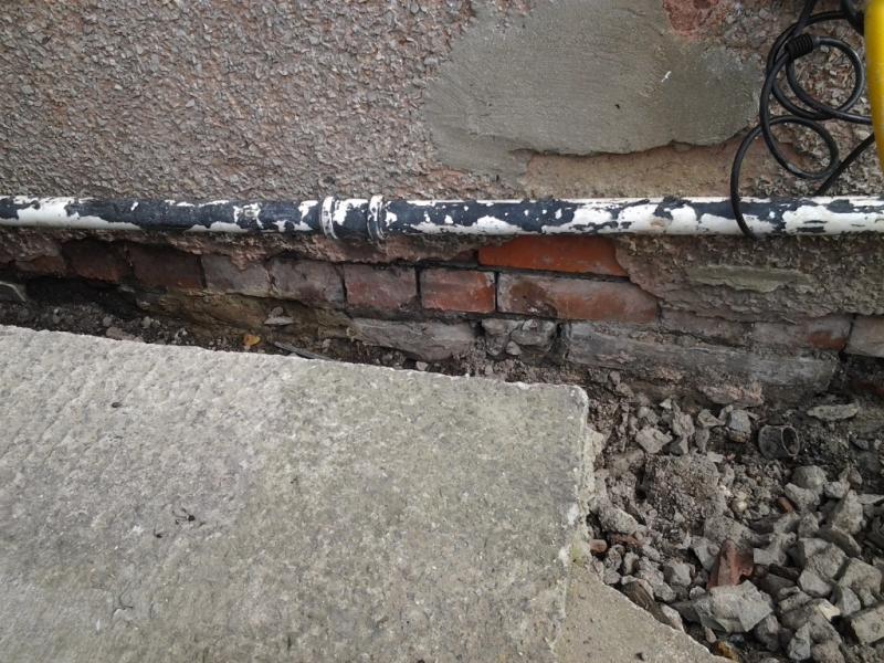

I did post about this in the past, but assumed that there would be more than one brick under DPC and over footings. Having dug out now, I can see that to get the depth under DPC, i'd expose the footings...
Previous owners had concrete poured over DPC to make driveway. Substantial woodworm to adjacent floor boards.
Now digging down with plan to fill with washed gravel, but to what levels?
The bituminous strip is on top of a single brick over footings, which are large stones.
If I expose the footing stones, might they shift over time and should I point them?
I am uncertain about making a french drain- I cannot see water pooling, so is this not of use?

How high is the concrete over the DPC, your picture does not seem to show it. Also are you sure that you have reached the base of the footings ? .i.e. poked a crowbar under the footings at an angle, to make sure that there are no further courses of stone? even in stone built houses the footings are wider at their base then at their tops.

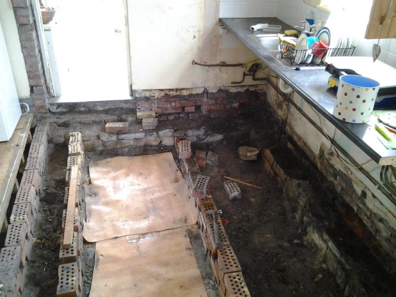

Sorry for misleading in this respect; no the footings are indeed about a 18"deep. Pic attached. I replaced timber floor to kitchen this week. DPC sits above one brick which is bedded onto footings. Footings are built into the room by about 9" stepping down on the way.
So I haven't exposed bottom of footings.
